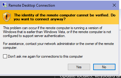

Using RDT on windows 10:
Logging in as normal user gives blue screen which closes after a few seconds.
Windows Rdt informs me
Which I assume corresponds to the log entries
[ERROR] Cannot read private key file /etc/xrdp/key.pem: Permission denied
and
[WARN ] Cannot accept TLS connections because certificate or private key file is not readable. certificate file: [/etc/xrdp/cert.pem], private key file: [/etc/xrdp/key.pem]
ls -al gives
lrwxrwxrwx  1 root root    36 Oct 19 09:23 cert.pem -> /etc/ssl/certs/ssl-cert-snakeoil.pem
lrwxrwxrwx  1 root root    38 Oct 19 09:23 key.pem -> /etc/ssl/private/ssl-cert-snakeoil.key
so link permissions OK
but
-rw-r----- 1 root ssl-cert 1704 Oct 19 09:23 ssl-cert-snakeoil.key
-rw-r--r-- 1 root root 1078 Oct 19 09:23 /etc/ssl/certs/ssl-cert-snakeoil.pem
So I brute forced a chmod 777 to the two files and now I don’t get the error in the log but the desktop opens and closes immediately.
I reverted the chmods and it doesn’t complain any more. Don’t understand this unless the certs have inherited the link’s permissions.
I installed the cert on the windows machine but it still complains so I accept the error each time.
It’s telling me that the server name is incorrect and it’s not from a trusted authority.

Did you install XRDP via dietpi-software? It runs as xrdp user, which requires access to the key, which is, as you showed, a symlink to the snakeoil key by default. In dietpi-software we hence do usermod -aG ssl-cert xrdp, adding xrdp to the ssl-cert group, which grants it read access to the snakeoil key (not needed for the public cert).
Note to myself, open MR to add this to the Debian package: debian/xrdp.postinst · master · Debian Remote Packaging Team / xrdp · GitLab
And of course the snakeoil cert is not from a trusted authority, which is why it is called snakeoil cert :wink:. So this is for encryption only, but cannot guarantee authenticity. For that you would need a TLS certificate from a public CA like Let’s Encrypt, use that one as well as the related public domain name to connect to the RDP server. The snakeoil cert is not really meant for long-term usage, but more for testing/setting up things. But within strictly isolated and trusted local networks it might be enough. This is probably also the reason the Debian XRDP maintainer did not even think about making it work with that, but IMO not great to ship it with a config that must fail OOTB.
