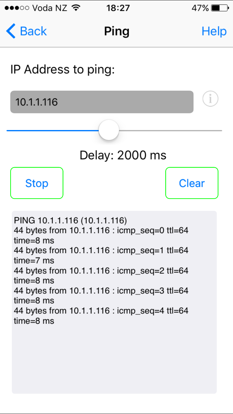

Finally, we’d just like to rule out any network connectivity issues between your iOS device and your pi. The easiest way to so this is to download a free app from the appstore called called Network Ping Lite.
Start the app once installed and select Ping from the list of tasks on the first screen. On the next screen enter the IP address or your pi (displayed on each login or provided by the ifconfig command above) and hit the start button:
Let us know if the output you see in the grey box is similar to my screenshot or if instead you see Request timeout messages.
