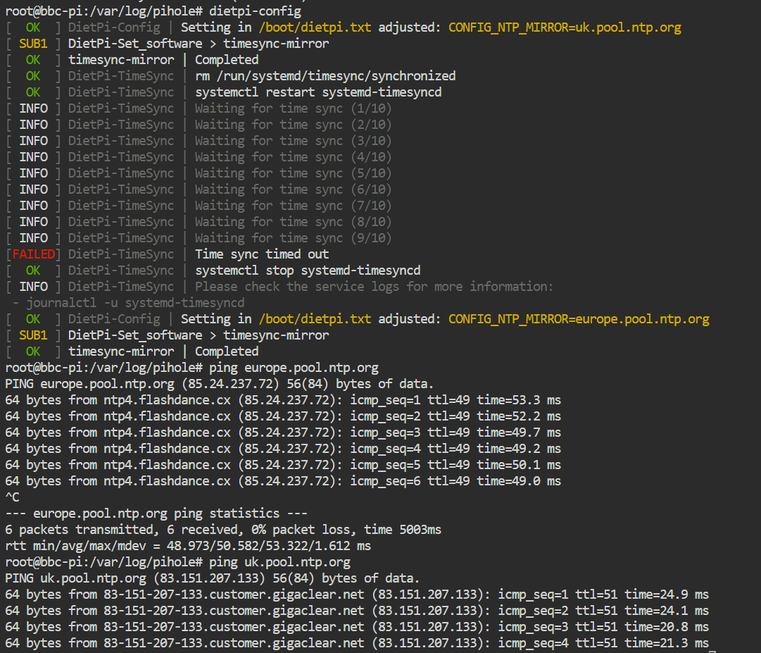

I’m not sure how to copy\paste from my terminal. So a quick screen shot of what happened, plus the double check of some pings
Set your clock out of sync and try. Put your time back a minute and see if you can reproduce.

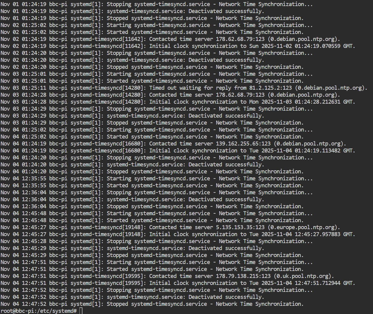

Can you have a look into
journalctl -u systemd-timesyncd
No idea why Debian mentioned in there. When I looked at dietpi-config it initially showed europe.pool.ntp.org before my attempted change.
The ones at 12:36 are the failed attempt shown in the screenshot.
After 12:45 is when I found my accidental fix of dietpi-update. And 12:47 will be my successful change.

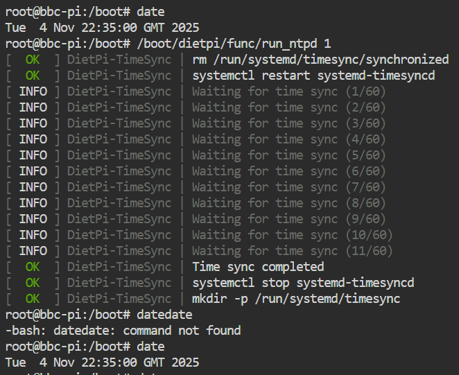

This PI3 is shockingly badly off with the clock. I checked just now, 10 hours later. And it is another 20 seconds out. Thanks to the command supplied I can now request a sync… but that fails on the first 10 attempts. Which kinda matches the earlier situation where it only tried 9 times before giving up.
The funny part of the above image is the clock was 20 seconds out at the start… and then the fix took 20 seconds to complete. So it looks like time stood still while the clock corrected :grin:
What makes me curious are the 11 attempts required to sync. This explains why that initial attempt of changing the NTP server fails as it is just too slow to respond for ten tries.
Don’t know why it is so slow… a second attempt gets a reply on the first try.

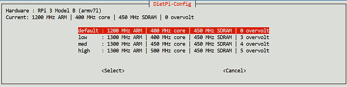

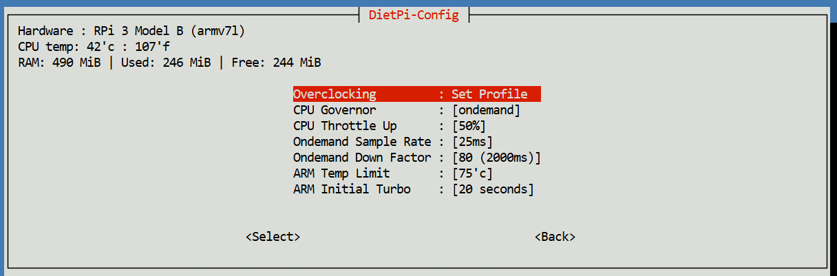

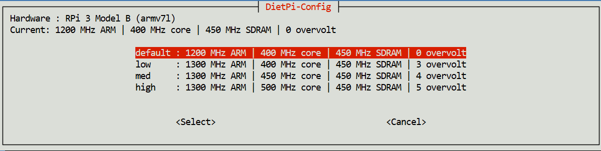

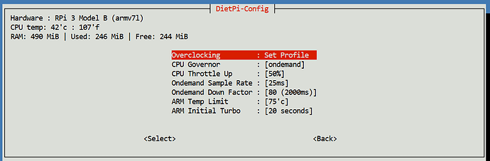

@MichaIng you mention about not reducing the CPU frequency. As far as I know this is still left on stock (screenshots above). I have never actually touched it so don’t know what is should be.
I tested for which CPU frequencies are available and it listed 600000 to 1200000. So I have made a tweak of trying 700000 for now and see what happens.
