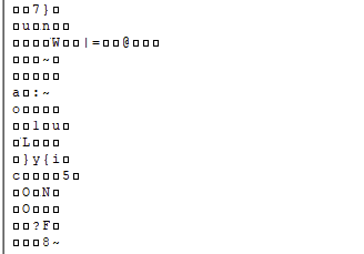

Serial console: Only hieroglyphs :(
  • DietPi version |
    G_DIETPI_VERSION_CORE=9
    G_DIETPI_VERSION_SUB=12
    G_DIETPI_VERSION_RC=1
  • Distro version | bookworm
  • Kernel version | Linux SV-ADS-B 5.10.160-legacy-rk35xx #1 SMP Wed Jul 10 09:57:26 UTC 2024 aarch64 GNU/Linux
  • Architecture | arm64
  • SBC model | Radxa ZERO 3 (aarch64)
  • Power supply used | 5.2V 5A
  • SD card used | Samsung Pro Plus
  1. Set in “dietpienv.txt”: consoleargs=console=ttyS2,115200 console=tty1 console=ttyFIQ0,115200
  2. Connect USB2SER to PIN-header
  3. Start Putty-SER or TerraTerm or hTerm on COM2, 115200,n,8,1
  • See the console in the terminal like a Raspberry ZERO or similar
  • Checked different speeds; all the same.
Am I doing something wrong here, or is this a bug?

Did you try with 1,500,000 baud rate? Also in dietpiEnv.txt. I wonder why ttyS2 is present there. Did you add it manually? ttyFIQ0 should be the default/debug UART used by U-Boot etc. Though I see that there is at least not dedicated debug UART port/pins, so probably ttyS2 is needed, being the common GPIO pins 6+8+10 UART2.
Radxa docs weirdly talk about ttyUSB0 :face_with_spiral_eyes:: UART Serial Console | Radxa Docs
But … quite possible that one of the USB ports (in case likely the power port itself) act as USB UART, which would then indeed appear as ttyUSB0. Such could be seen when powering it via other system’s USB port. E.g. on Windows you’d then see another USB communication being setup. Or … somewhat internally GPIO pins 6-8-10 are attached via USB bus, no idea what’s possible :sweat_smile:.

No, I hadn’t tried it yet, because most terminal programs don’t support it. Following your suggestion, I set Putty to that value, and sure enough! Despite other settings in the ENV file, it still works at this high data rate…
Then the question naturally arises: what good are the settings in the ENV file if they simply do nothing?

The baudrate for u-boot is hardcoded to 1.5M.
The settings in dietpiEnv.txt affect only the kernel command line, but early boot via U-Boot uses 1.5M baudrate, that’s the gibberish you see.
(Changing the baudrate for u-boot is not so easy, you probably need to build u-boot by yourself)
So why not just use 1.5M also for console? (:
https://stackoverflow.com/a/4948623/23919129
In u-boot, you can set the environment variable baudrate to specify the console baud rate. When you boot the kernel, you can have u-boot pass the kernel contents of the bootargs environment variable. That becomes the kernel command line. In that, you can set the kernel’s console’s baud rate. Most systems I’ve seen have something like this: bootargs=console=ttyS1,115200n8 ... That sets the baud rate independently of u-boot. If, you instead had something like bootargs=console=ttyS1,${baudrate}n8 ..., then the kernel would get the same baud rate as u-boot is using.
