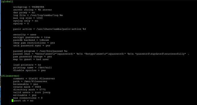

und meine Smb.conf sollte eigentlich auch passen, siehe Screenshot

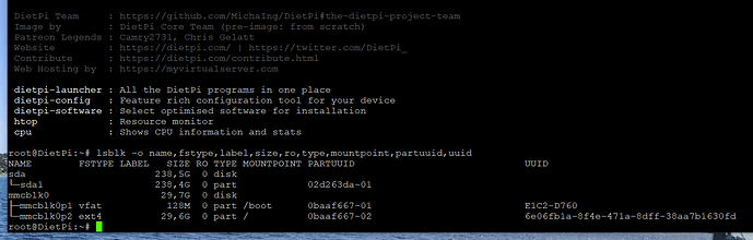

it’s just 1 HDD sda but having 2 different partitions sda1/2.
can you share following?
Good morning Joulinar,
I have attached the screenshot.
The hard disk is displayed correctly, but there are two partitions that I did not consciously create.

The goal should be to format the partition within dietpi-drive_manager as ext4 and then mount it.
With lsblk and df -h, additionally to dietpi-drive_manager, you can monitor the result.

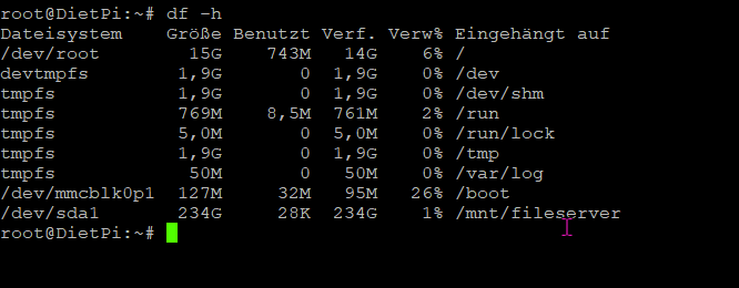

yes that ist fine, you should see the drive attached as well using
df -h
Yes I can see it that way now too

I reinstalled the samba during the reinstallation.
Unfortunately, the smb.conf now looks quite different.
I don’t know how to set the shares now.
I think I can create the questions here, or is that wrong?
How did you do that? Did you used dietpi-software? As it looks like the original smb.conf and not the one we provide with our install script.
One hint. If possible, try to avoid screen prints. You should be able to copy nearly everything from SSH terminal directly and past it into your post. :wink:
Yes I installed it with the script under dietpi-software
but i must have accidentally installed the client instead of the server :frowning:
ok can you remove the client? Once done, go with server install.
I have uninstalled the clietn and installed the server.
Now it looks like I know it again

and you still have permission issues I guess? I guess you need to set correct permission for user dietpi
chown -R dietpi:dietpi /mnt/fileserver
