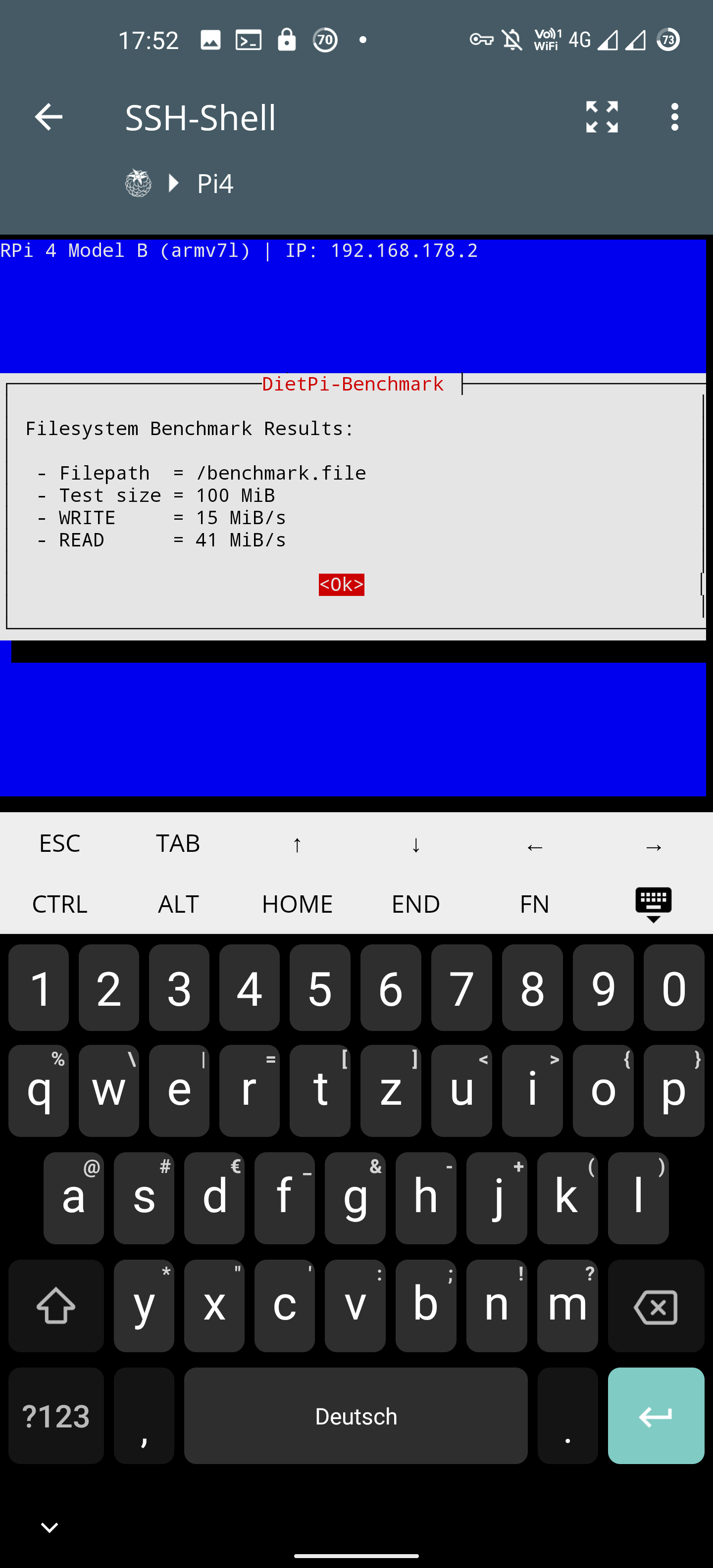

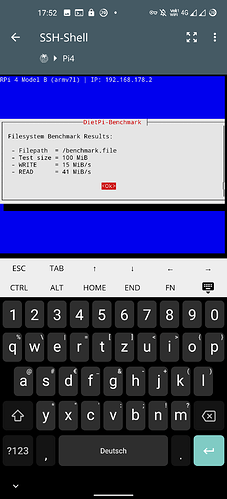

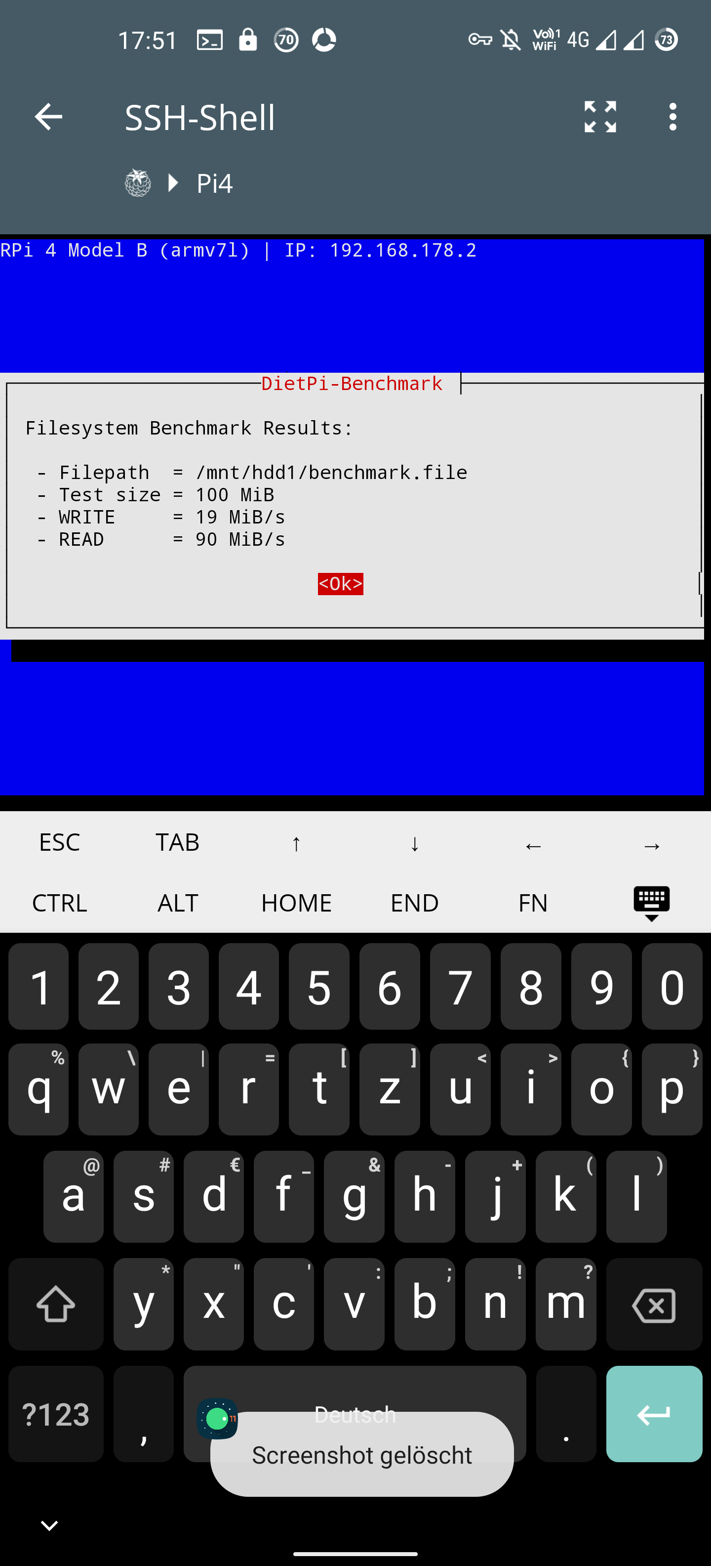

I’m also not able to get over 12mb/s transfer speed on my rpi4. Connected via 5GHz Fritzbox only. I am using a usb3 hard drive.
Would be interesting which raw drive write speed you achieve and which network speed when transferring via other protocols, like NFS, SFTP or FTP.
This is the benchmark for my NTFS USB 3.0 hard drive I am using for samba and pulling files from:
