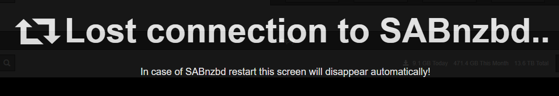

Hi, I just updated Dietpi with detpi-update command and I’m running 9.15.2.
SABnzbd starts and is accessible in the browser, but when start downloading it looks lke the service crash and I lost the connection to it and no download happens. The rest of the services still work. If I restart the system, it shows up again and crash, the only way to prevent is deleting the download in progress at the moment it starts.
I have reinstalled it but the issue keep going.
Anyone has the same issue?
When I tried to restart the service manually I get this message:
Job for sabnzbd.service failed because a fatal signal was delivered to the control process.
Thanks.

β–‘β–‘ Subject: Resources consumed by unit runtime
β–‘β–‘ Defined-By: systemd
β–‘β–‘ Support: Debian Support
β–‘β–‘
β–‘β–‘ The unit sabnzbd.service completed and consumed the indicated resources.
Aug 03 19:54:27 DietPi systemd[1]: sabnzbd.service: Scheduled restart job, restart counter is at 2.
β–‘β–‘ Subject: Automatic restarting of a unit has been scheduled
β–‘β–‘
β–‘β–‘ Automatic restarting of the unit sabnzbd.service has been scheduled, as the result for
β–‘β–‘ the configured Restart= setting for the unit.
Aug 03 19:54:27 DietPi systemd[1]: Stopped sabnzbd.service - SABnzbd (DietPi).
β–‘β–‘ Subject: A stop job for unit sabnzbd.service has finished
β–‘β–‘
β–‘β–‘ A stop job for unit sabnzbd.service has finished.
β–‘β–‘
β–‘β–‘ The job identifier is 957 and the job result is done.
Aug 03 19:54:27 DietPi systemd[1]: sabnzbd.service: Consumed 1.190s CPU time.
β–‘β–‘
Aug 03 19:54:27 DietPi systemd[1]: Started sabnzbd.service - SABnzbd (DietPi).
β–‘β–‘ Subject: A start job for unit sabnzbd.service has finished successfully
β–‘β–‘
β–‘β–‘ A start job for unit sabnzbd.service has finished successfully.
β–‘β–‘
β–‘β–‘ The job identifier is 957.
Aug 03 19:54:29 DietPi SABnzbd[4840]: double free or corruption (out)
Aug 03 19:54:29 DietPi systemd[1]: sabnzbd.service: Main process exited, code=killed, status=6/ABRT
β–‘β–‘ Subject: Unit process exited
β–‘β–‘
β–‘β–‘ An ExecStart= process belonging to unit sabnzbd.service has exited.
β–‘β–‘
β–‘β–‘ The process’ exit code is β€˜killed’ and its exit status is 6.
Aug 03 19:54:29 DietPi systemd[1]: sabnzbd.service: Failed with result β€˜signal’.
β–‘β–‘ Subject: Unit failed
β–‘β–‘
β–‘β–‘ The unit sabnzbd.service has entered the β€˜failed’ state with result β€˜signal’.
Aug 03 19:54:29 DietPi systemd[1]: sabnzbd.service: Consumed 1.400s CPU time.
β–‘β–‘
Aug 03 19:54:29 DietPi systemd[1]: sabnzbd.service: Scheduled restart job, restart counter is at 3.
β–‘β–‘
Aug 03 19:54:29 DietPi systemd[1]: Stopped sabnzbd.service - SABnzbd (DietPi).
β–‘β–‘
β–‘β–‘
β–‘β–‘ The job identifier is 1037 and the job result is done.
β–‘β–‘
Aug 03 19:54:29 DietPi systemd[1]: sabnzbd.service: Start request repeated too quickly.
β–‘β–‘
Aug 03 19:54:29 DietPi systemd[1]: Failed to start sabnzbd.service - SABnzbd (DietPi).
β–‘β–‘ Subject: A start job for unit sabnzbd.service has failed
β–‘β–‘
β–‘β–‘ A start job for unit sabnzbd.service has finished with a failure.
β–‘β–‘
β–‘β–‘ The job identifier is 1037 and the job result is failed.
Aug 03 19:54:39 DietPi systemd[1]: sabnzbd.service: Start request repeated too quickly.
Aug 03 19:54:39 DietPi systemd[1]: sabnzbd.service: Failed with result β€˜signal’.
β–‘β–‘
Aug 03 19:54:39 DietPi systemd[1]: Failed to start sabnzbd.service - SABnzbd (DietPi).
β–‘β–‘
β–‘β–‘
β–‘β–‘ The job identifier is 1117 and the job result is failed.
Aug 03 19:54:41 DietPi systemd[1]: sabnzbd.service: Start request repeated too quickly.
Aug 03 19:54:41 DietPi systemd[1]: sabnzbd.service: Failed with result β€˜signal’.
β–‘β–‘
Aug 03 19:54:41 DietPi systemd[1]: Failed to start sabnzbd.service - SABnzbd (DietPi).
β–‘β–‘
β–‘β–‘
β–‘β–‘ The job identifier is 1197 and the job result is failed.
Aug 03 19:54:54 DietPi systemd[1]: sabnzbd.service: Start request repeated too quickly.
Aug 03 19:54:54 DietPi systemd[1]: sabnzbd.service: Failed with result β€˜signal’.
β–‘β–‘
Aug 03 19:54:54 DietPi systemd[1]: Failed to start sabnzbd.service - SABnzbd (DietPi).
β–‘β–‘
β–‘β–‘
β–‘β–‘ The job identifier is 1278 and the job result is failed.
Not sure if it is same as the exit code is different one
for reference, issue at sabnzbd GitHub Crash when start download Β· Issue #3122 Β· sabnzbd/sabnzbd Β· GitHub
Per the github, it appears that debian users got a new kernel update (6.1.0-37 - which is kernel 6.1.140) and that is causing the problem. Not Dietpi, not SABznbd.
So, is there a way to downgrade it? Or that is not recommended?
I follow the Sab issue on their GitHub as the discussion is still ongoing. Seems more related to OpenSSL?? Not sure. At least we should wait on the discussion before trying to downgrade the kernel.
Btw: it seems to impact native pc only. Other devices like RPi SBC running different kernel.
There is a workaround provided within the Sab GitHub issue. Hope it’s working until issue has been fixed upstream by OpenSSL guys Crash when start download Β· Issue #3122 Β· sabnzbd/sabnzbd Β· GitHub
Thanks!. I would wait. Don’t want to mess with my dietpi setup. Meanwhile I setup as downloader NZBGet, I don’t like it but gets the job done.
Today I noticed after checking apt-get upgrade, that there is an update for openssl. I have applied and so far is working.
