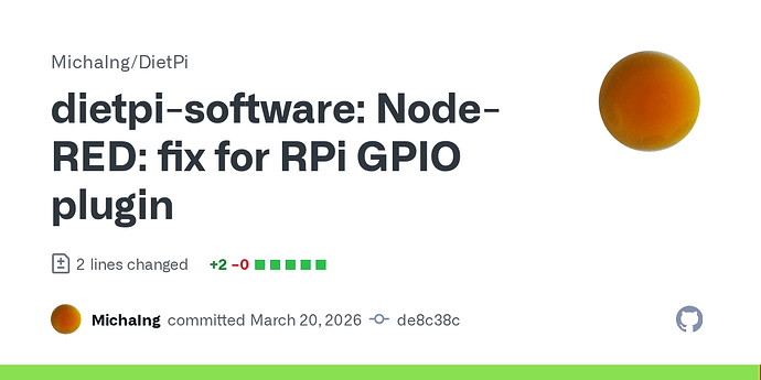

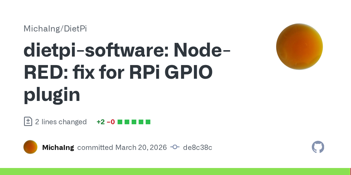

This should fix it:
Will be applied also during next DietPi update.
Thank you.
