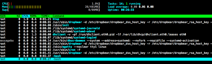

Today this happend to me, while testing RPi Zero W installation:
Using: DietPi_v150_RPi-armv6-(Jessie).img
=> auto update to DietPi v158 during first boot up (incl. DietPi kernel and firmware update)
=> at inital setup dialog change form Dopbear to OpenSSH Server for file access
=> select Install and
=> apt-get upgrade starts to install 45 updated packets and firmware + selected software installation with finally auto-reboot
But no SFTP (SCP) file transfer is possible . So I have checked:
choose now: Dropbear Lightweight SSH Server (Recommended)
DietPi-Software
Mode: Uninstall
Please wait...
[Ok] Uninstalling OpenSSH Server:
Reading package lists... Done
Building dependency tree
Package 'openssh-server' is not installed, so not removed
after auto-reboot reinstall OpenSSH
Sorry no logs, using DietPi-Ramlog.
root@RPi-Zero-W:~# systemctl status dropbear -l
● dropbear.service
Loaded: not-found (Reason: No such file or directory)
Active: inactive (dead)
root@RPi-Zero-W:~# systemctl status ssh -l
● ssh.service - OpenBSD Secure Shell server
Loaded: loaded (/lib/systemd/system/ssh.service; enabled)
Active: active (running) since Fri 2017-12-08 15:26:28 UTC; 43min ago
Thanks,
So it seems the cause have been spotted, it’s not clear to me how to solve it without being able to login.
I might have missed something obvious…
