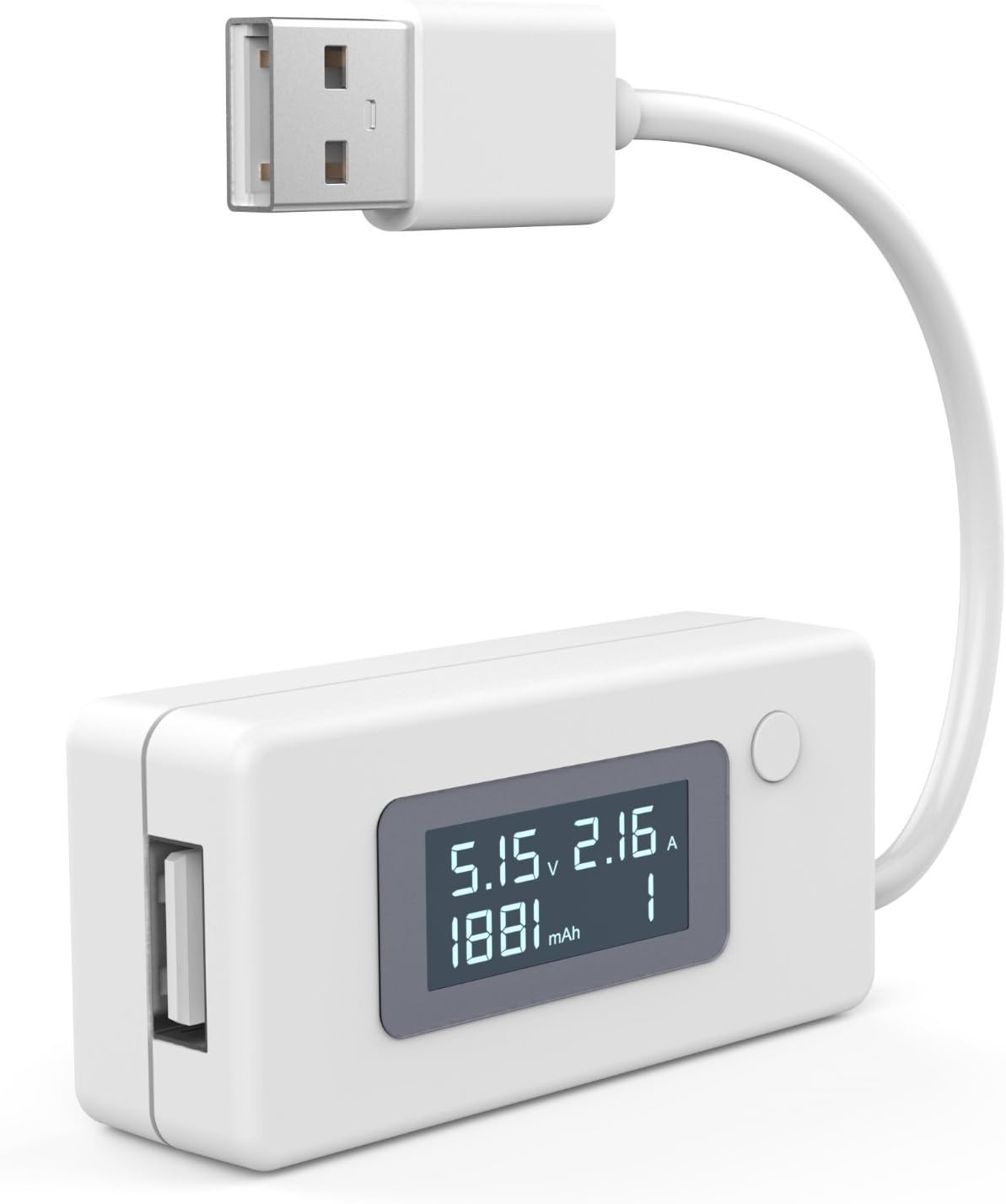

If the AUDIOPHONICS I-Sabre V3 DAC power management is hardware based, should be fine. When audio is not being sent through the card, it should be using less power anyway, but you’d need to use a USB power meter to test it (these are awesome fun btw):
