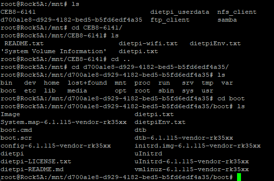

I can mount the emmc yes but i don’t have the /boot directory to check the kernel version
no i don’t have en UART adapter
you would need to enter the drive mounted. Actually, you are still at /mnt which is not the mounted drive
is it what you need?

So Linux 6.1 vendor kernel, okay.
