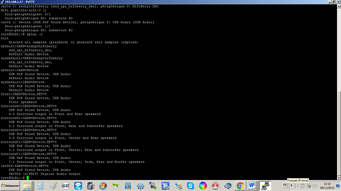

Typing aplay -l
I get :
**** Liste des Périphériques Matériels PLAYBACK ****
carte 0: sndrpihifiberry [snd_rpi_hifiberry_dac], périphérique 0: HifiBerry DAC HiFi pcm5102a-hifi-0 []
Sous-périphériques: 1/1
Sous-périphérique #0: subdevice #0

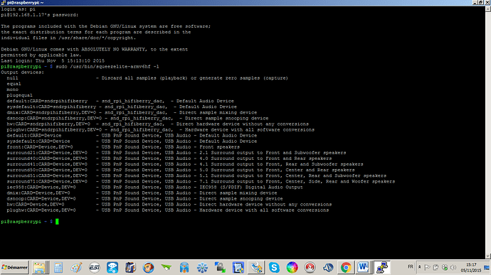

When typing :
sudo /usr/bin/squeezelite-armv6hf -l
I get :
Output devices:
null – Discard all samples (playback) or generate zero samples (capture)
default:CARD=sndrpihifiberry – snd_rpi_hifiberry_dac, – Default Audio Device
sysdefault:CARD=sndrpihifiberry – snd_rpi_hifiberry_dac, – Default Audio Device
no equal ?
If I do :
sudo /usr/bin/squeezelite-armv6hf -o default:CARD=sndrpihifiberry
I get sound playing through the I2S Sound Card but no equalisation
if I do :
sudo /usr/bin/squeezelite-armv6hf -o sysdefault:CARD=sndrpihifiberry
if I do :
sudo /usr/bin/squeezelite-armv6hf -o equal
I get the following error :
*** glibc detected *** /usr/bin/squeezelite-armv6hf: double free or corruption (!prev): 0x01559078
Any idea of what is wrong ?
