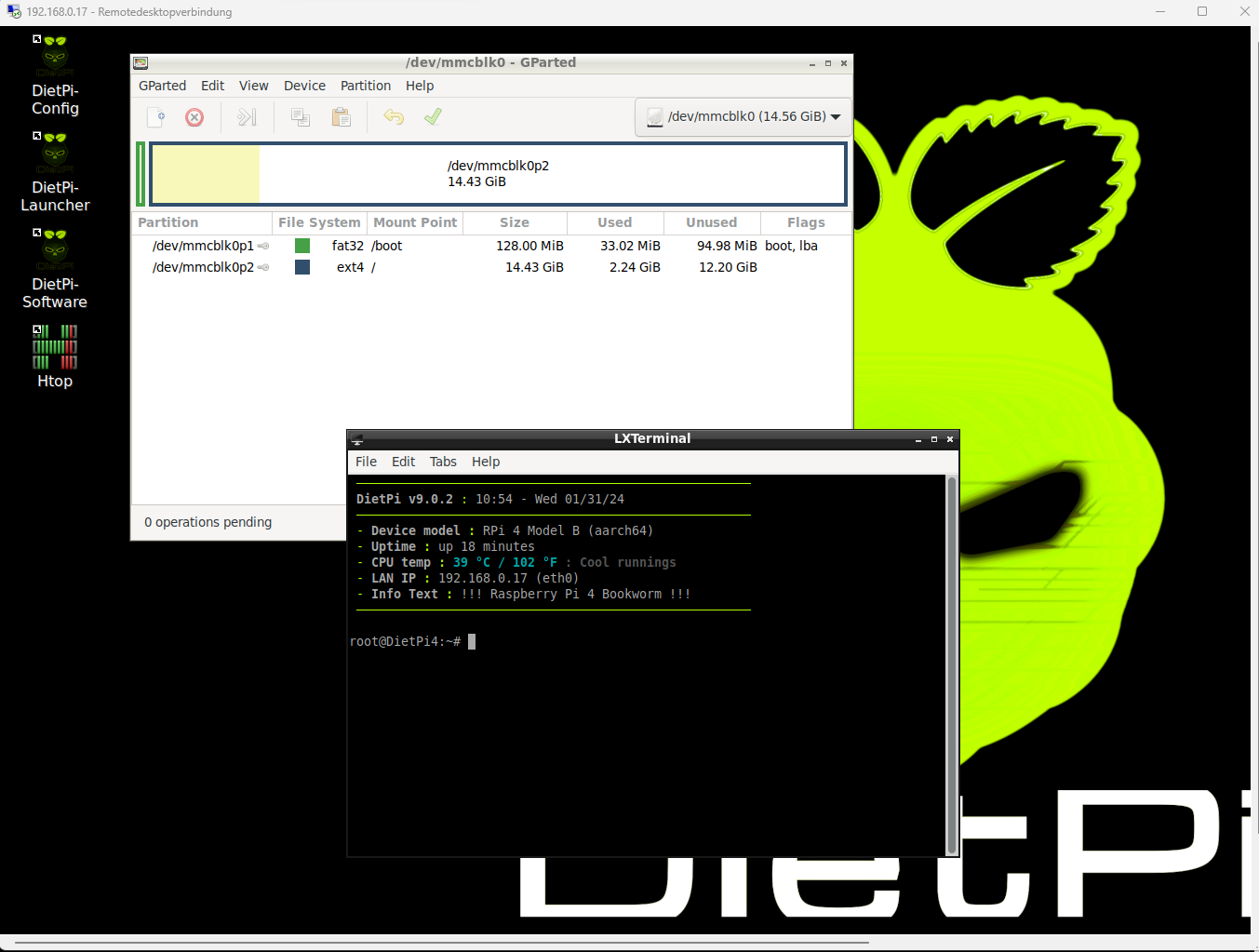

hmm for me GParted is working without issues on RPi4. At least I can start the app
Thanks for the info Joulinar, I made a new install and try it again :raising_hand_man: wimduk
Hallo Joulinar and Jappe,
My problem is SOLVED (I think).
After a fresh installation I installed and started Gparted as root and everthing went fine. As user wim I have according to Dietpi not the right permissions to start Gparted and the loading process stops.
On my Raspberry I am allowed to start Gparted as user wim and then I am prompted to fill in the root password in a messagebox to continue. Small difference big surprise for a first time dietpi user :sweat_smile:
