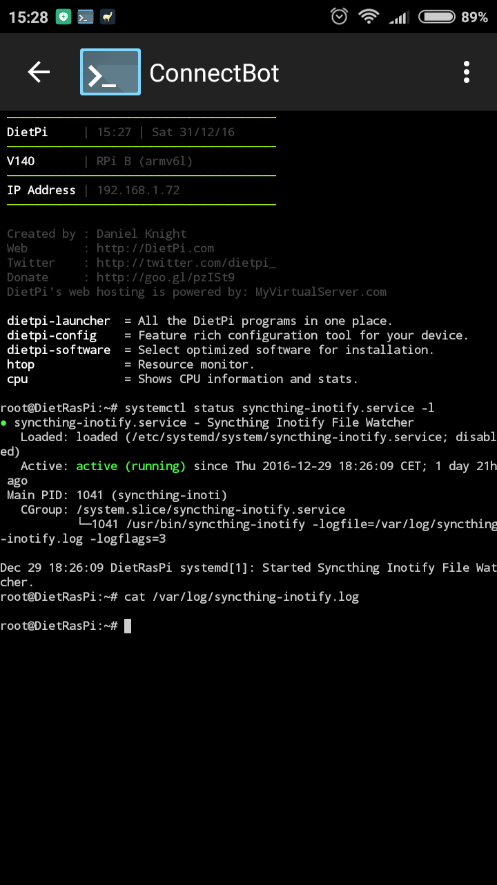

Check for any errors in service:
systemctl status syncthing-inotify.service -l
And also, check log for any errors:
cat /var/log/syncthing-inotify.log
Paste results here and i’ll take a look.
I can’t see any errors (sorry I can’t copy and paste, I hope the attachment is fine anyway).
Yep,service looks good.
Pictures, screenshots, SSH pastes, its all good :slight_smile:
Remember that DietPi-RAMlog clears logs every 1 hour. So you may need to reboot, then try to recreate the issue in Syncthing, then recheck log file again straight afterwards.

I can’t seem to have any valid information in the log. It’s always empty, even immediately after I make changes to a synced file.
It really looks like syncthing-inotify does not detect file changes at all.
