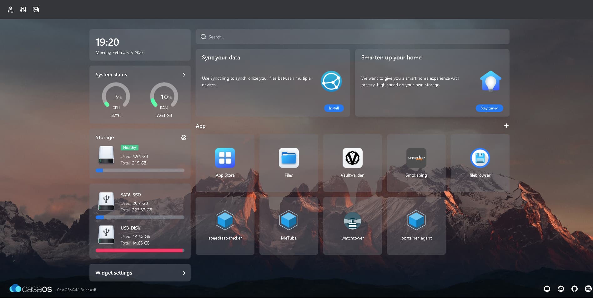

Just found this…an install that has self contained dashboard and many many apps built in for docker
Been testing it and it runs like a boss on my RPI 4 w/ 8GB RAM
This is currently what I have setup and running…
The data is stored in /DATA on the root partition

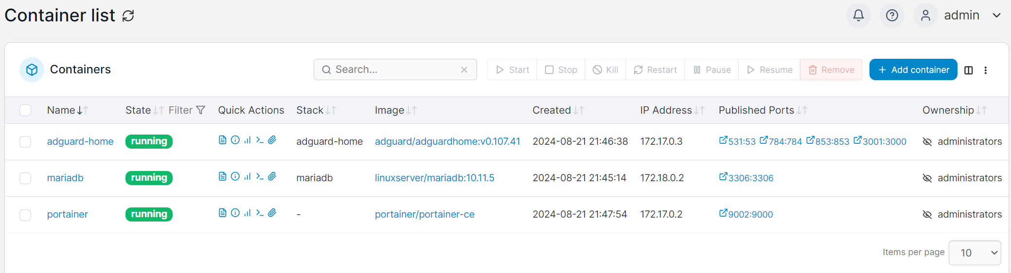

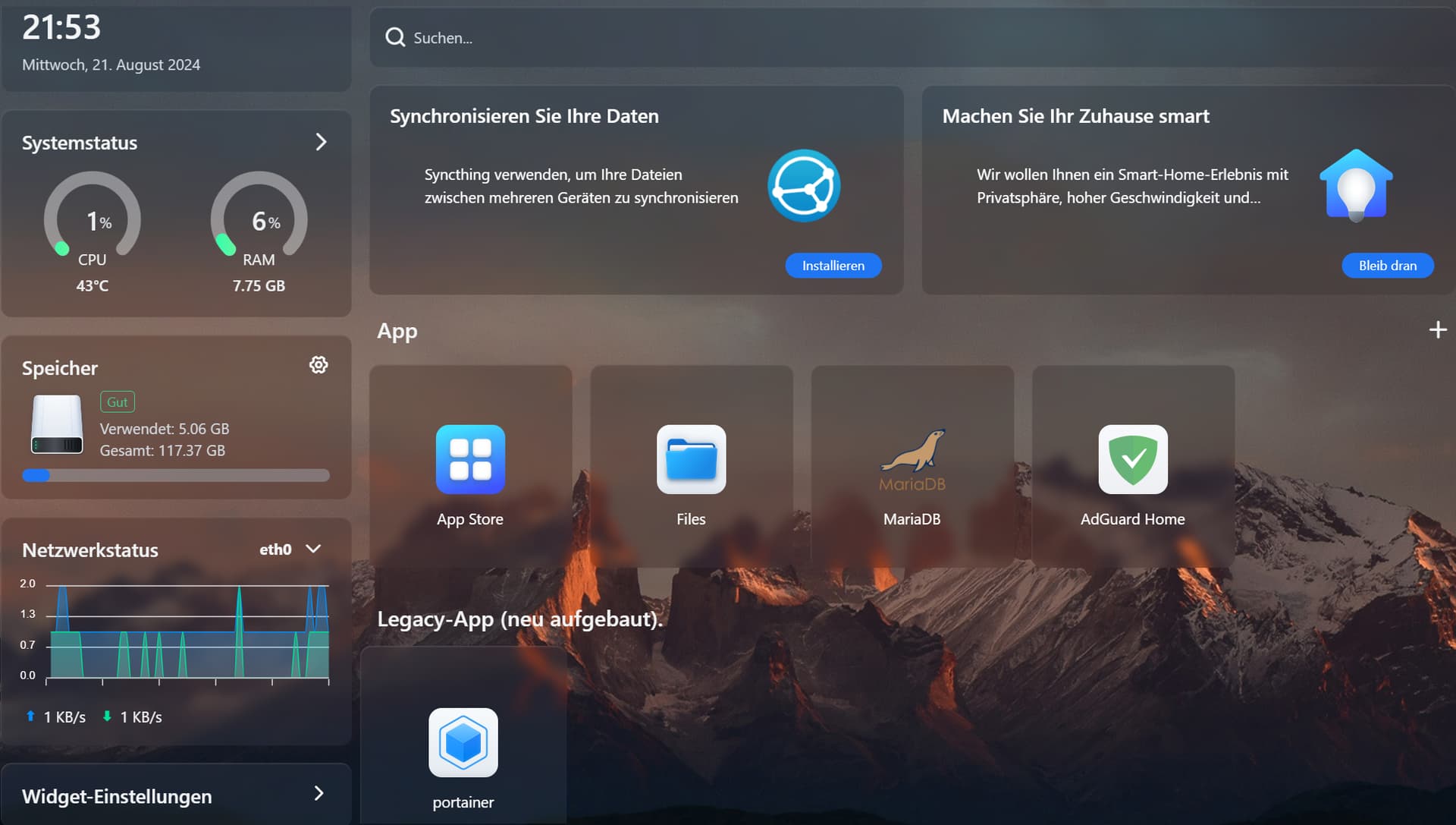

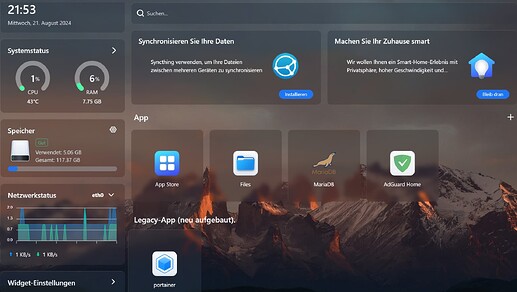

I just did a test and it works without any problems. Casa itself appears to be a set of executables. However, any apps that are installed through Casa will be a Docker container.
This is my test Casa
And these are all Docker containers
