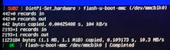

I have exactly the same problem with my HC4, do you found a solution? I also deleted Petitboot as per Armbian instructions but nothing changed.
I flashed also U-boot but didn’t solved. During reboot the machine is completely dead, the only solution is a power cycle.
