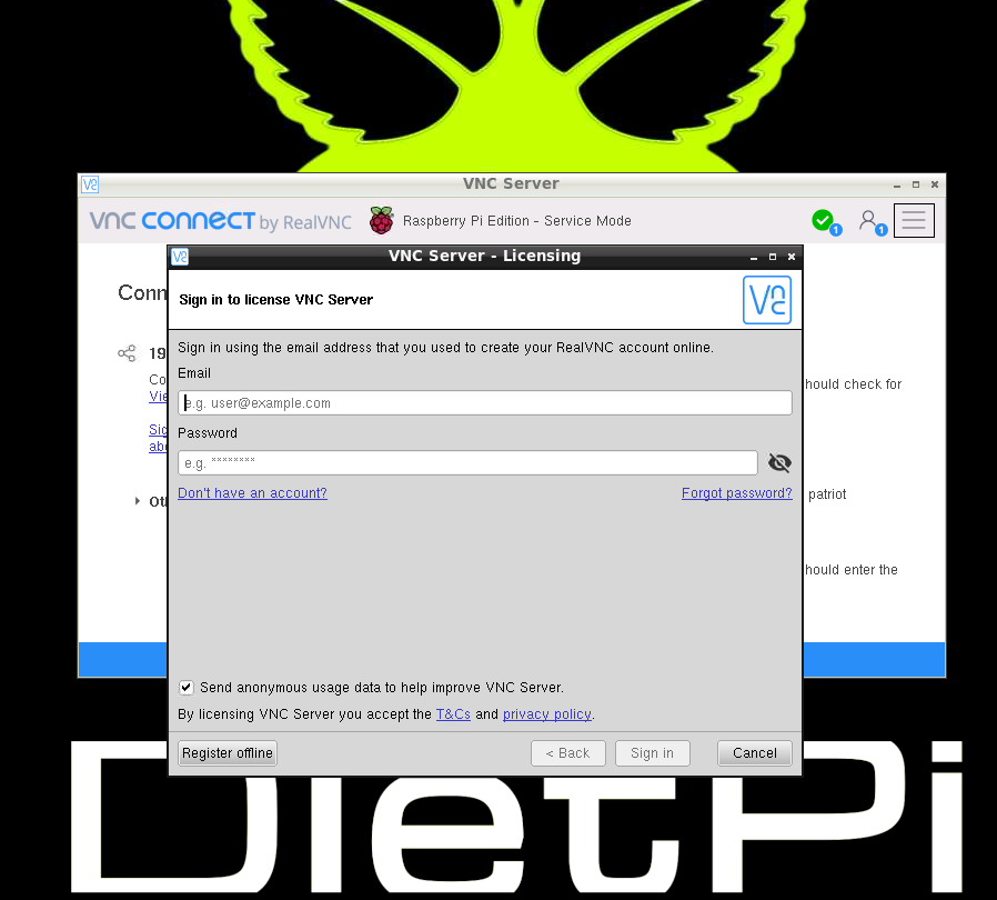

Thanks for the link, but unfortunately I cannot locate the “licensing…” under options.

ok I figured out how it is working. A little bit disappointing but it is working in shared mode only. Means you would need to start into a real desktop and adjust VNC server setting to connect to it
dietpi-autostart 2
G_CONFIG_INJECT 'SOFTWARE_VNCSERVER_SHARE_DESKTOP=' 'SOFTWARE_VNCSERVER_SHARE_DESKTOP=1' /boot/dietpi.txt
reboot
VNC desktop is available on screen ID 0 now as it is shared mode and you should be able to see the license filed.

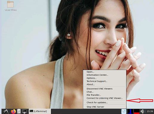

I have tried accessing VNC on a real screen, however from there I can’t see the VNC icon on the tray. It only shows while accessing Pi via VNC (Local).
But with your suggestion, I think it might work now. I’ll let you know if it worked for me.
