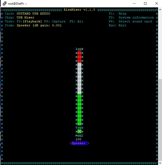

I installed Raspotify on my Allo USBridge .It plays Music but with no effect on the Justboom EQ. It seems Raspotify outworks the Justboom Equlizer. Other sources (foobar-GMRender) playing through the EQ and taking effect. Any suggestion?
Regards Christoph
Edit Ups the attechments disappeared?!
ASLA Output
First: Foobar-GMRender EQ Justbom works
Second: Spotify-Raspotify EQ Justboom not working
Indeed the issue is that Raspotify skips ALSA and connects to a chosen sound device directly. This means it also skips the equalizer. There is an open issue about that with a solution that seems to work: https://github.com/dtcooper/raspotify/issues/23
I hope you can verify that it is working. If so I think we should implement it into our Raspotify installer to avoid confusion.
