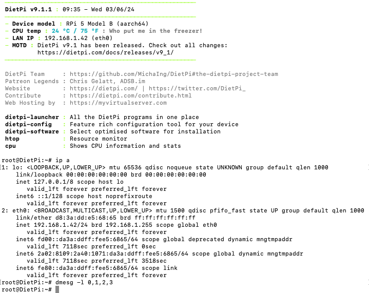

did you checked if an IP address has been assigned?
ip a
Or kernel log for critical messages
dmesg -l 0,1,2,3
pls see attached some screen shots :
After changing to static ( ip 1.42 )
This morning I made a fresh install and it took again 30-40 mins until the ip settings changed again
At present system boots from an NVME drive, later I will try from USB → ssd and see what happens there
it seems to have a valid IP address 192.168.1.42. Are you able to ping gateway? or could the IP address be assigned by your DHCP server to another device resulting duplicate IP? Did you tried to use a STATIC IP address from outside DHCP address range?
