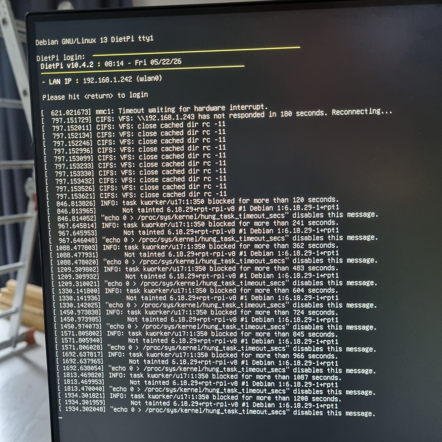

Here’s a pic of the errors, I can’t access any logs due to the errors. :frowning:

CIFS: VFS: \\192.168.1.243 has not responded in 180 seconds
task kworker/... blocked for more than ... seconds
repeated close cached dir rc -11
So the CIFS share does not respond, it’s not available for some reason. I guess you already checked on the Pi400 and the CIFS server is active?!

The hanging comes indeed from docker. Containers repeatedly touching the dead SMB mount can spam kernel workers, can deadlock processes and make shutdown/reboot impossible without pulling power.

Yes, the RPi400 and samba share are still active, I can access them fine. Which is strange because it implies the RPi3B thinks the RPi400 isn’t responding when it actually is. Here’s my fstab from before disabling caching:
//192.168.1.243/RPi400EHD /mnt/RPi400EHD cifs cred=/var/lib/dietpi/dietpi-drive_manager/mnt-RPi400EHD.cred,iocharset=utf8,gid=dietpi,file_mode=0770,dir_mode=0770,vers=3.1.1,noauto,x-systemd.automount

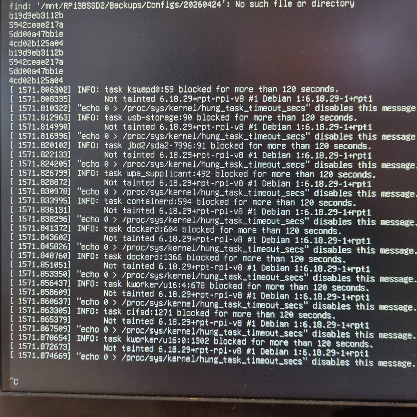

Plugging in an ethernet cable and rebooting allowed some of my daily backup script to run, docker configs from the RPi3B were backed up to the RPi400EHD mount, but then when being copied back to the RPi3B’s SSD, I ran into trouble again:

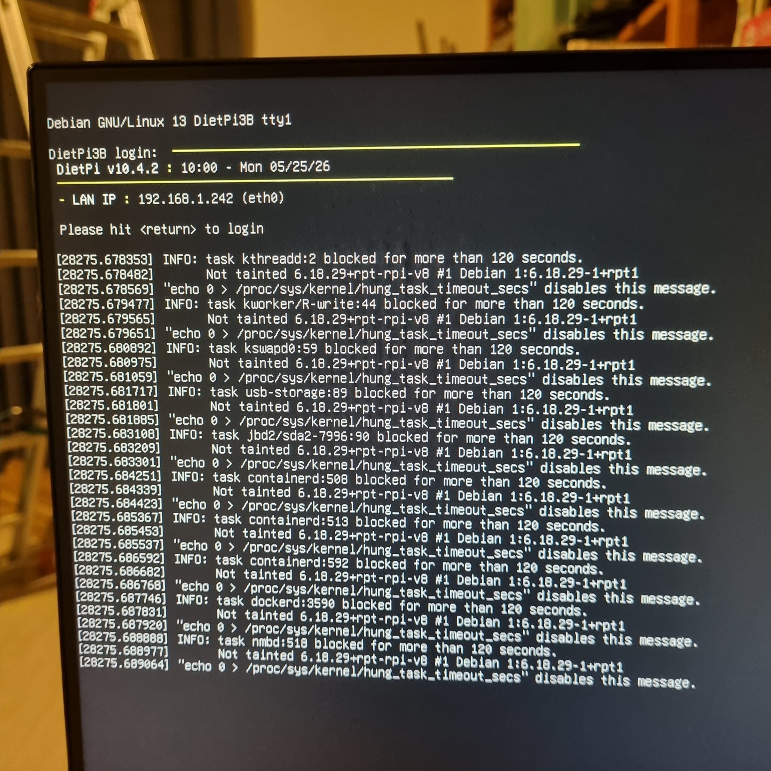

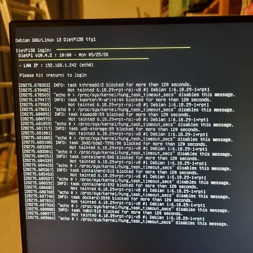

OK so problem not quite solved… still getting these errors (although less frequently / not so quickly after booting):
