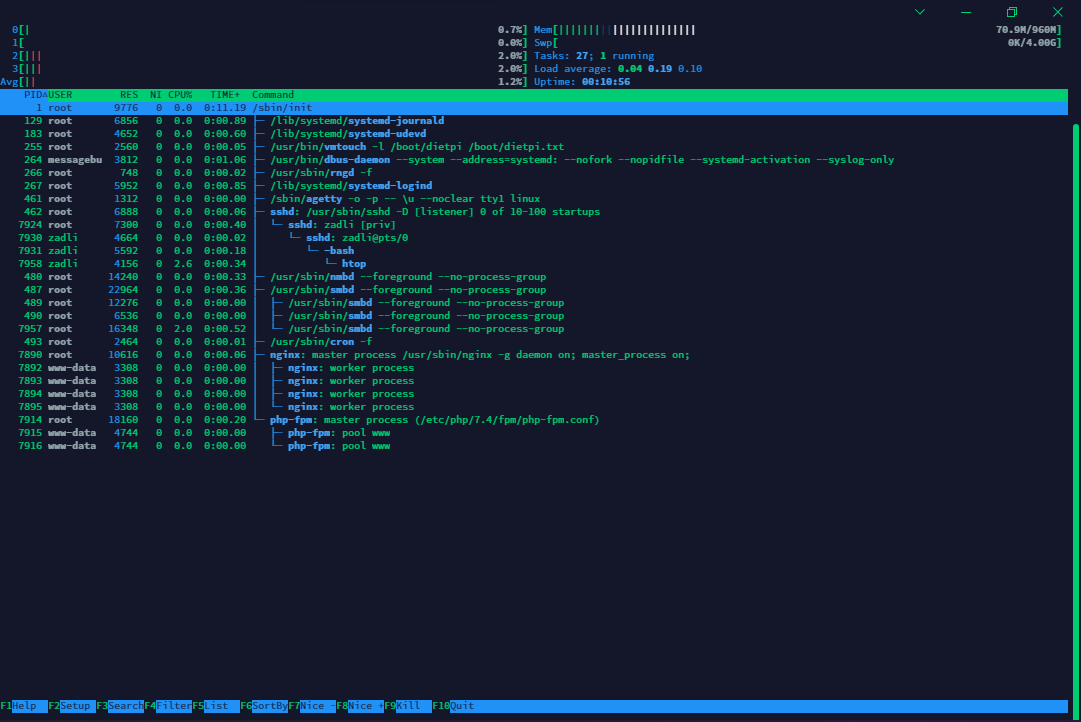

After updating to DietPi 7.7.3 i have around 64 degree in idle
How to fix that?
On previous build all has been okay
I reinstalled dietpi but it also works wrong

DietPi scripts themselves should not have suche impact. Maybe some other Debian packages has been installed via apt package manager. As an apt upgrade is part of DietPi update.

But with all of my packages temperature has been around 48 degrees
And after update it around 64
I reinstalled whole system and on clean system it stays on 64 degrees
i think trouble in new kernel
But i don’t know how to downgrade it on dietpi
