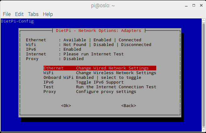

I installed Dietpi on a Pi 3 a few months ago, and probably disabled the wifi adapter at the time, as the pi was cabled.
Recently I thought I’d use it on wifi instead, but when I run dietpi-config, and go to network adapters, the status of the wifi is “not found | disabled | disabled”
If I attempt to enable it, Nothing happens, and even after a reboot the adapter is still “not found”.
If I look, /dev/wlan0 does not exist.
I saw that the changelog for dietpi 145 fixed a problem with wlan on p3, so I updated to this but I still have the problem - I cannot enable wifi.
(To ensure that the Pi 3 wasn’t faulty, I tried a fresh install of Dietpi on another SD card, and was able to enable wifi successfully there).

I attach a screenshot of the setup menu where I cannot enable the wifi module.
