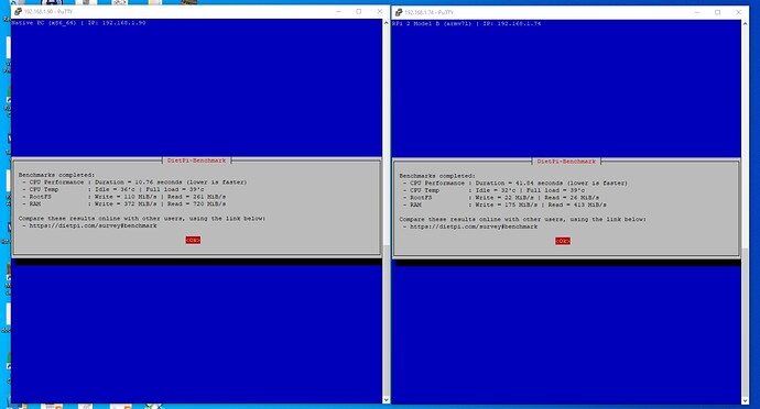

my raspberrypi-B2 and nuc having following benchmark.

mail2rst is not running a RPi1. He has a RPi2 Model B as you can see on his screen shot. Right picture, top left corner.
ah I see. So that explains the results :wink: … Does anybody of you run a Pi1 nowadays and can tell me about the browser performance?
