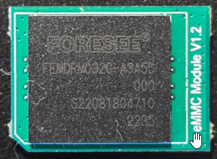

this is the used 32gb module:

I think I installed the official debian image from radxa and installed dietpi as a package afterwards at first installation.
I can remember it was a long procedure with many errors which I have to solve manually (since there was no image from dietpi at this time).
but the system runs the whole time from mmc as boot device (and system) while data is on a m2 ssd.
But I can’t remember if I installed it directly to emmc or moved the system from sd to emmc after installation…
