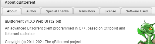

I am trying again with just installing Mate desktop and qbittorrent, but I faced the problem with the login in qbittorrent webadmin, that the password is not correct, isn’t this fixed as I read on github? I don’t remember what I did to reset the password…
P.D: nothing still the same no connection on udp trackers… With just installing qbittorrent and Mate desktop…
P. D. 2.: I was able to do all the steps to update but when I open qbittorrent still shows 4.1.5 version… I didn’t see any error during the update process
I install full qbittorrent not the Web ui included on dietpi and happens the same…
