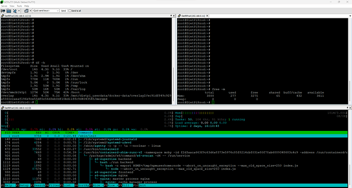

Given I’ve qBittorrent limited to using 512MB of ram, how is possible for it to saturate physical ram and use swap?
as stated above, some apps store temp data on file system. Usually this is /tmp. On DietPi we moved /tmp into memory :wink: . Means, it could eat your physical memory in parallel :smiley:
watch your system using htop, free -m and df -h. haha best to use 3 different sessions to get all :smiley:
So I’m better limiting qBittorrent to 256MB instead of 512MB?
Also, can you tell me how can I revert the zram command above and re-enable swap as it was before?
I guess a misunderstanding still. Limiting the memory usage has nothing to do with storing temporary data with /tmp.
Just keep it as is and watch memory usage. It doesn’t make sense to change to mutch.
