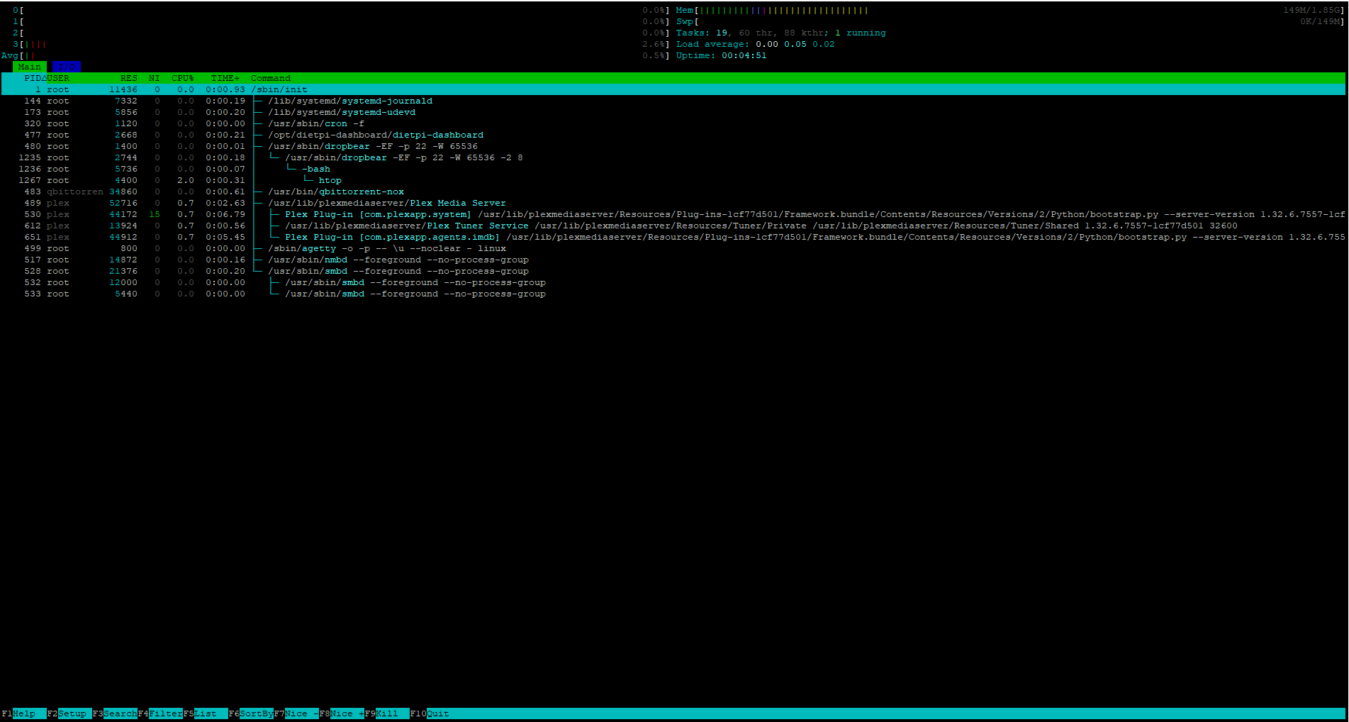

can you show htop as well. The memory consumption should be displayed in the upper right corner.
Here you go
Actually, the system is fine and the values between the dashboard and the operating system are the same.

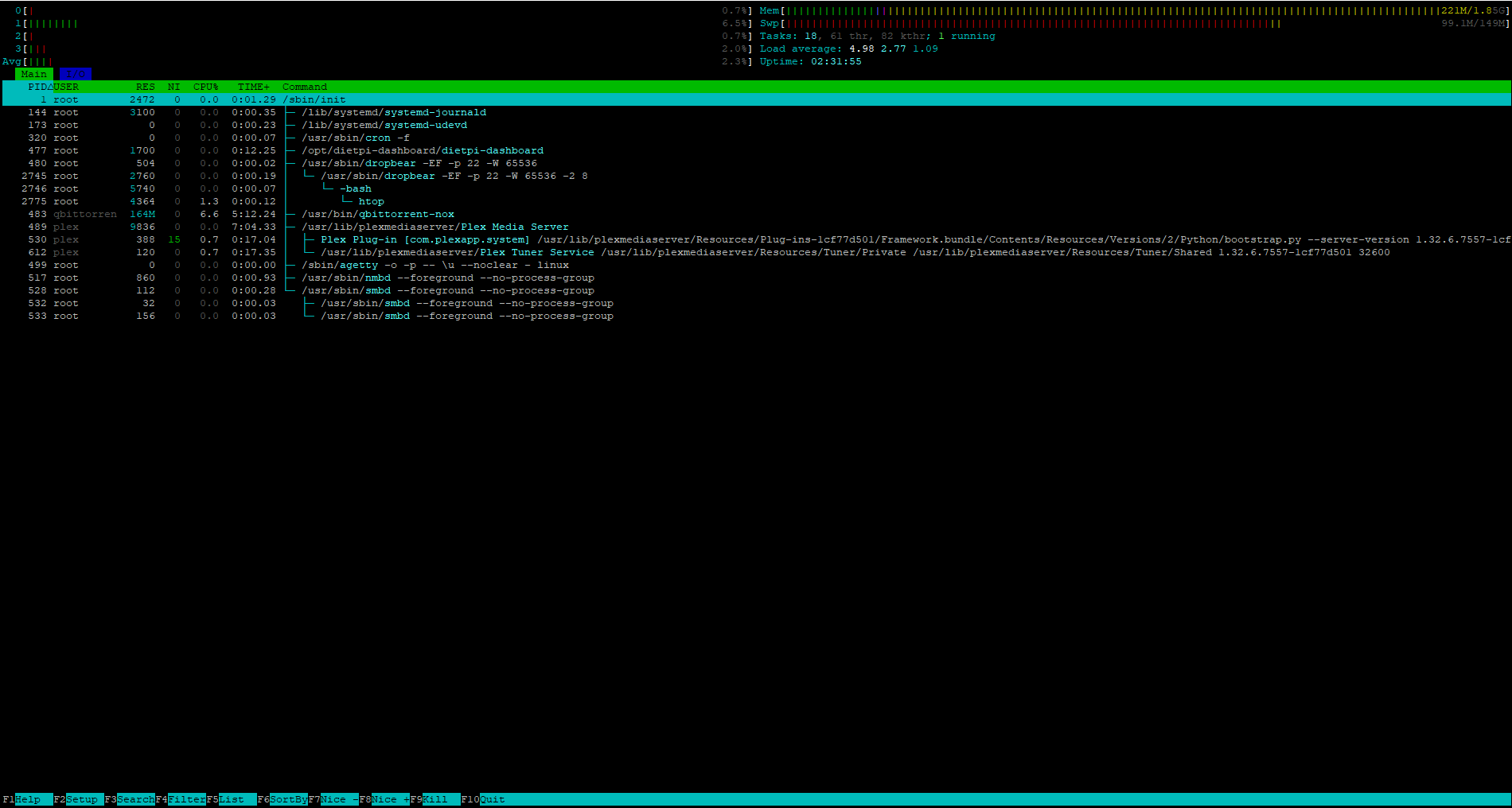

Will send a screenshot while torrenting.

Now torrenting ubuntu ISO:
