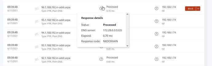

I have observed one weired thing. In my home LAN network there are two dietpi machines (one nuc and one raspberryPi). In raspberrypi I have installed bitwarden, homeassisttant & mqtt brocker via dietpi software. On nuc only docker & docker compose via dietpi-software (through docker compose plex,adguard, unbound & wireguard) both machines are running happily. But I observed both machines send PTR request to adguard (XX.1.168.192.in-addr.arpa). raspberry send PTR request to whole lan (192.168.1.1 to 192.168.1.254) every hour and in nuc side these request are coming after each 10 minute interval (only active lan devicies & docker internal network). So my question, is there any way to remove this reverse lan scan lookup thing as it unnecessary send request to dns resolver. Each day these are creating about 6K PTR request to my unbound system. In pihole or adguard forum it shown it is default patron but why reaspberry pi also sending these type of requests.

Please suggest me what i have to do in simple way. I already have A-record file in this format ’ local-data-ptr: “192.168.1.12 60 host.name”
local-data: “host.name. 60 A 192.168.1.12” ` in unbound. but this thing is only valid for known lan devices. raspberrpi send the dns request to unused lan ip addresses also. if this is issue related to upstream dns server then what you suggest for my raspberry custom upstream DNS would be for all other lan network devises my upstream dns server is 192.168.1.90 (through router) but for docker host machine(172.28.0.1) what should be our custom upstream dns server of raspberry pi running at 192.168.1.74 (192.168.1.90 [adguard/unbound/docker host], 172.28.0.2:53 [docker adguard], 172.28.0.3:5335 [docker unbound] or 1.1.1.1[external]) or 192.168.1.254[DHCP Server router]. if you see the screen shot raspberry pi send request to unbound for unused lan ip also.

Response details
Status
Processed
DNS server
172.28.0.3:5335
Elapsed
0.99 ms
Response code
NXDOMAIN
Response details
Status
Processed
DNS server
172.28.0.3:5335
Elapsed
0.87 ms
Response code
NOERROR
Response
PTR: rpi.local. (ttl=3600)
