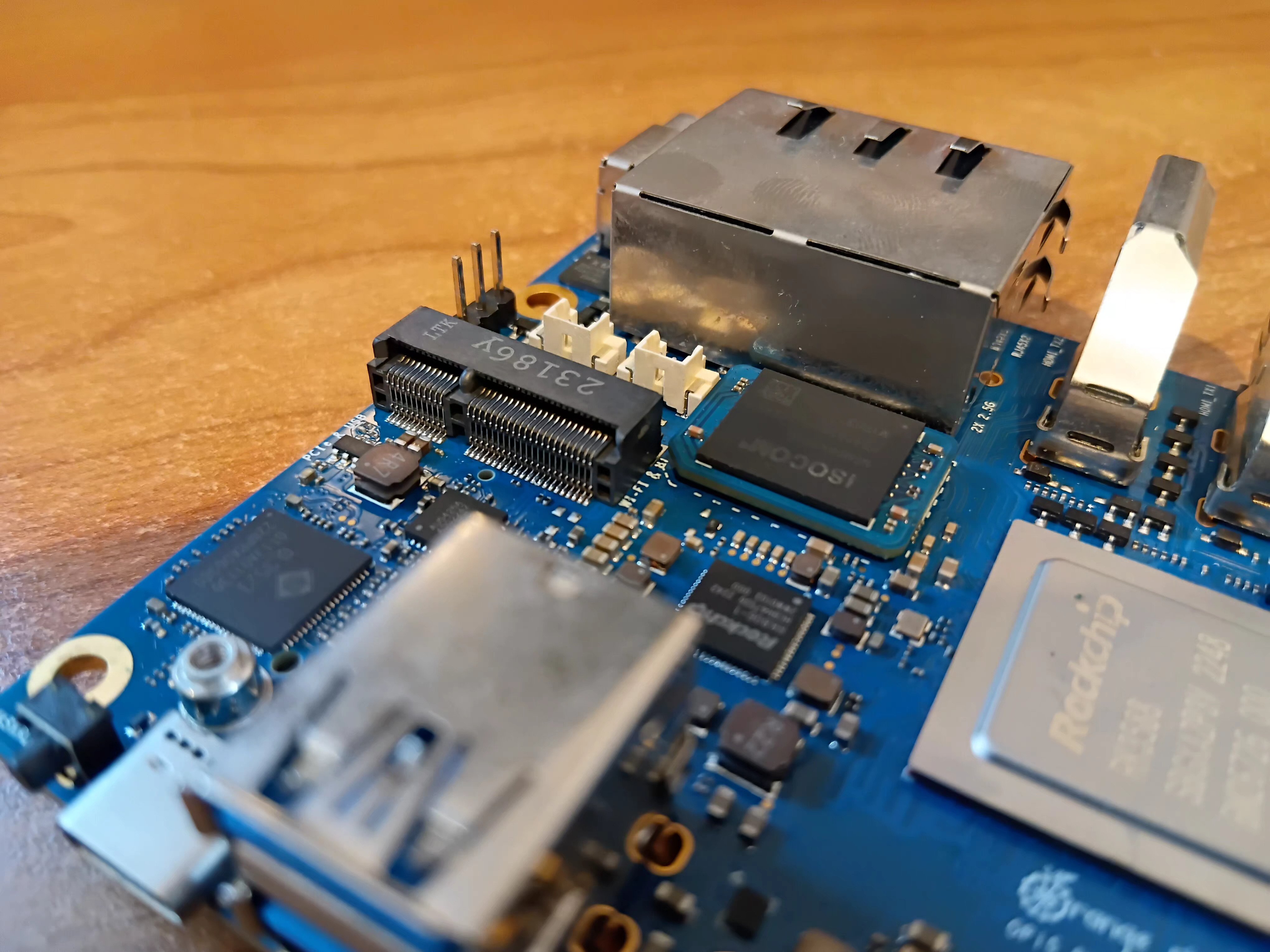

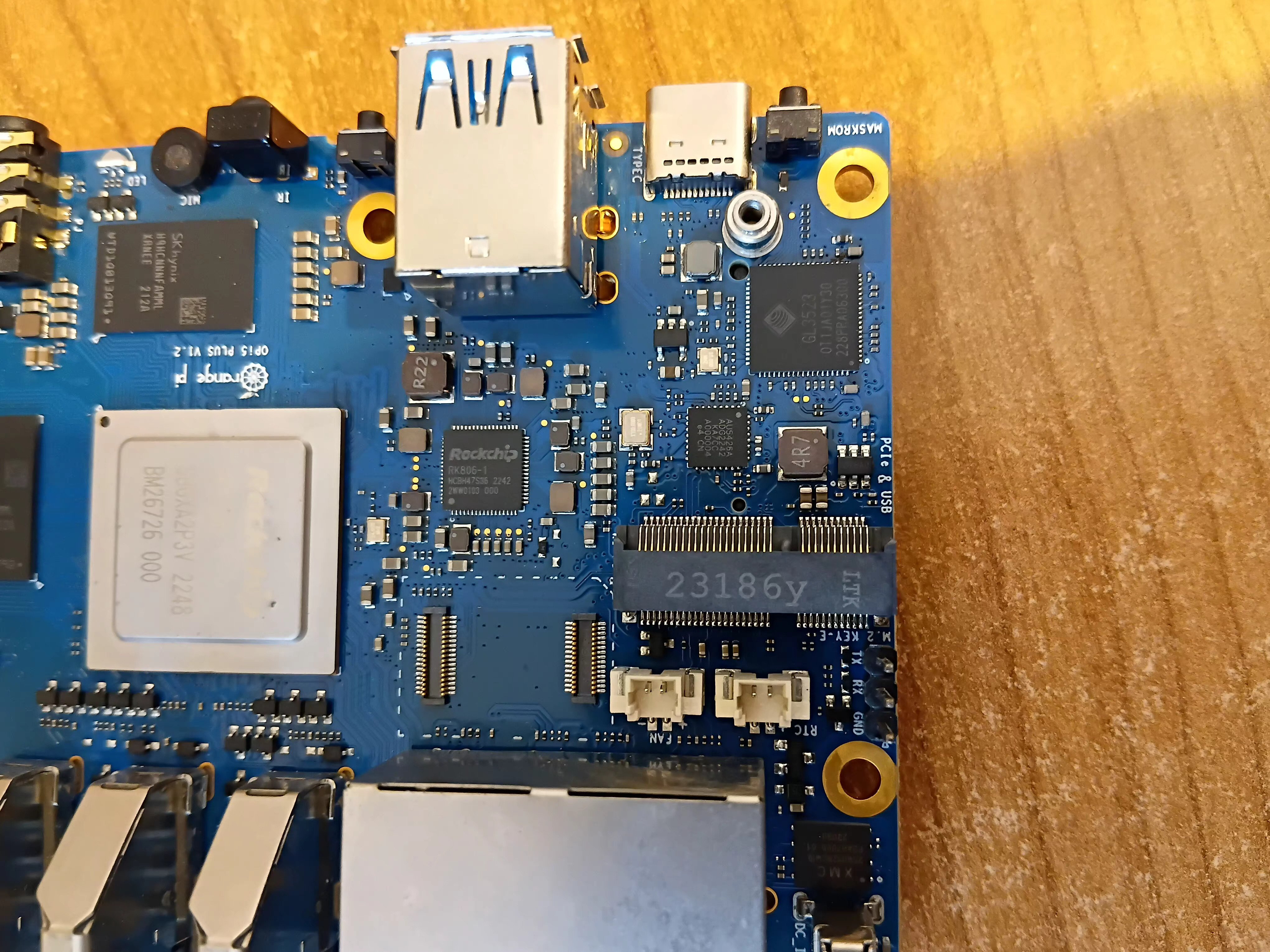

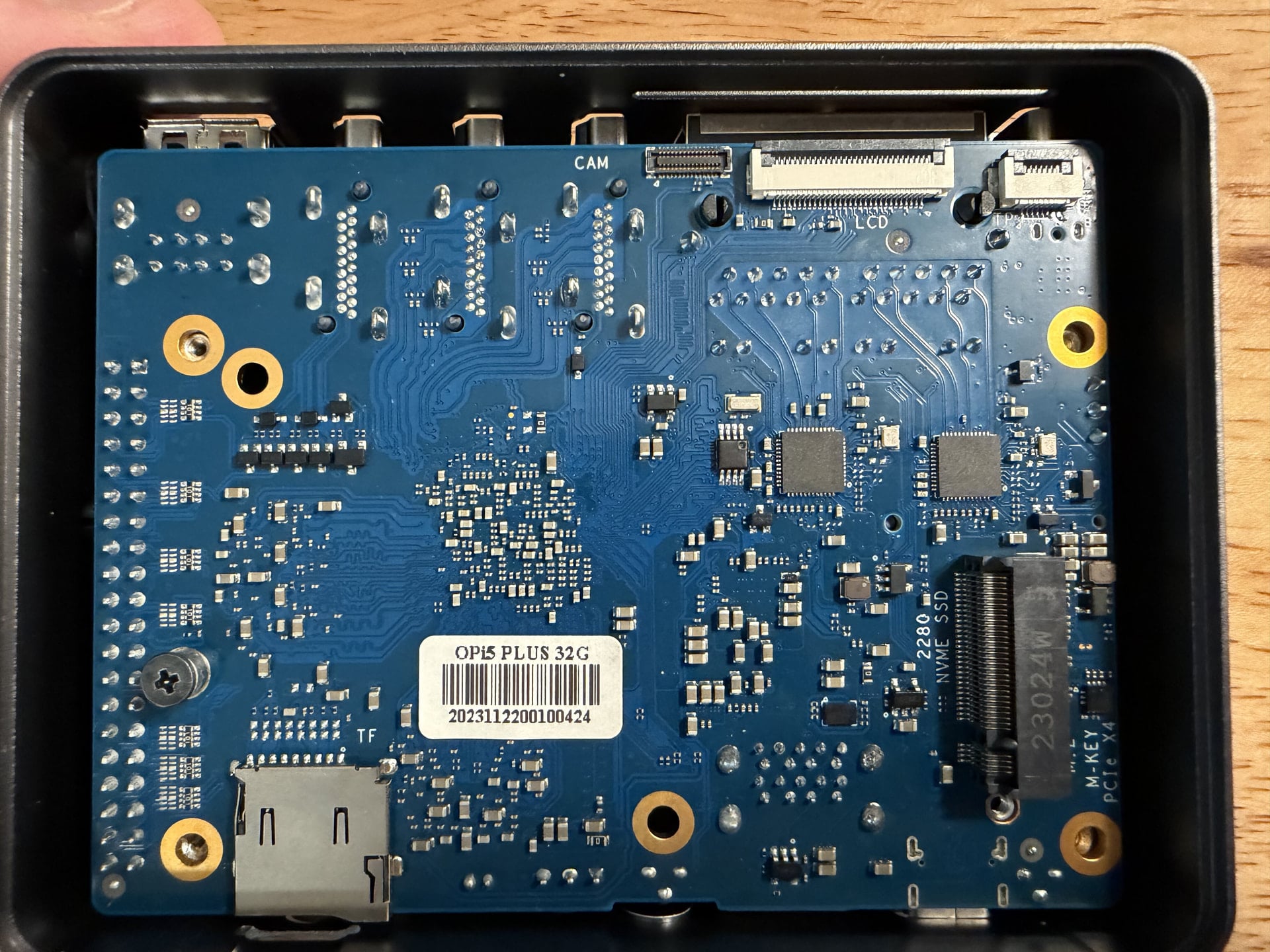

Another hardware question, out of interest: I am not able to attach the eMMC module a way that it looks fully safely plugged with both connector rows. The one at the FAN connector side always stays a bit higher than the one on the other side. It does work, no errors or so, but I have the impression that the FAN connector is located too close to the eMMC slot, preventing the module from being fully plugged without high pressure. Would probably need to file the either the FAN connector or the eMMC module a bit, so that it fully fits :thinking:. Is this the same for you?

I don’t recall having any issue getting it seated on both the actual live port side or the other one (which is just structural iirc. I don’t think there are any traces runing to it and it worked fine in my eMMC programmer I got from Pine64 which only has the one connector). I can pop it open and look though because now I am curious if I:

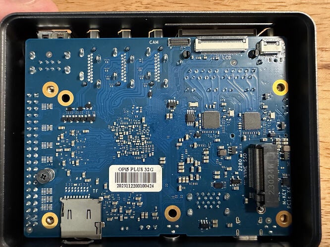

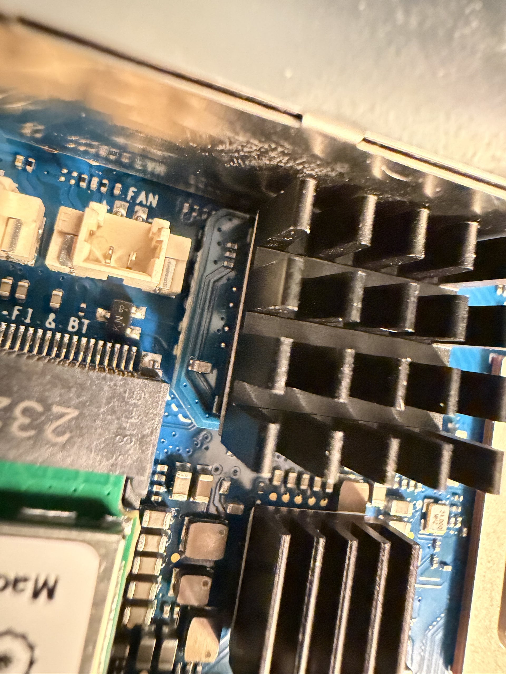

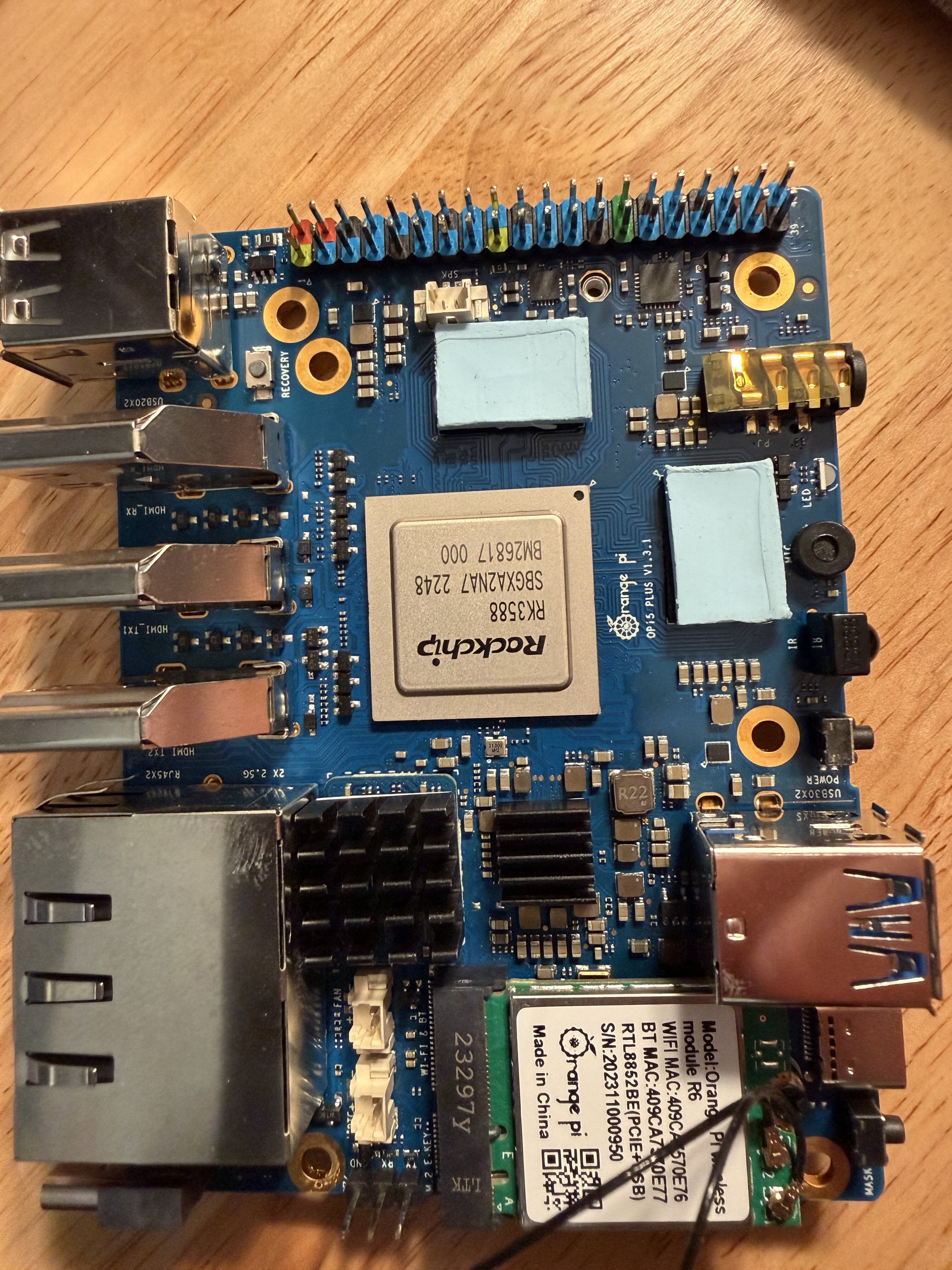

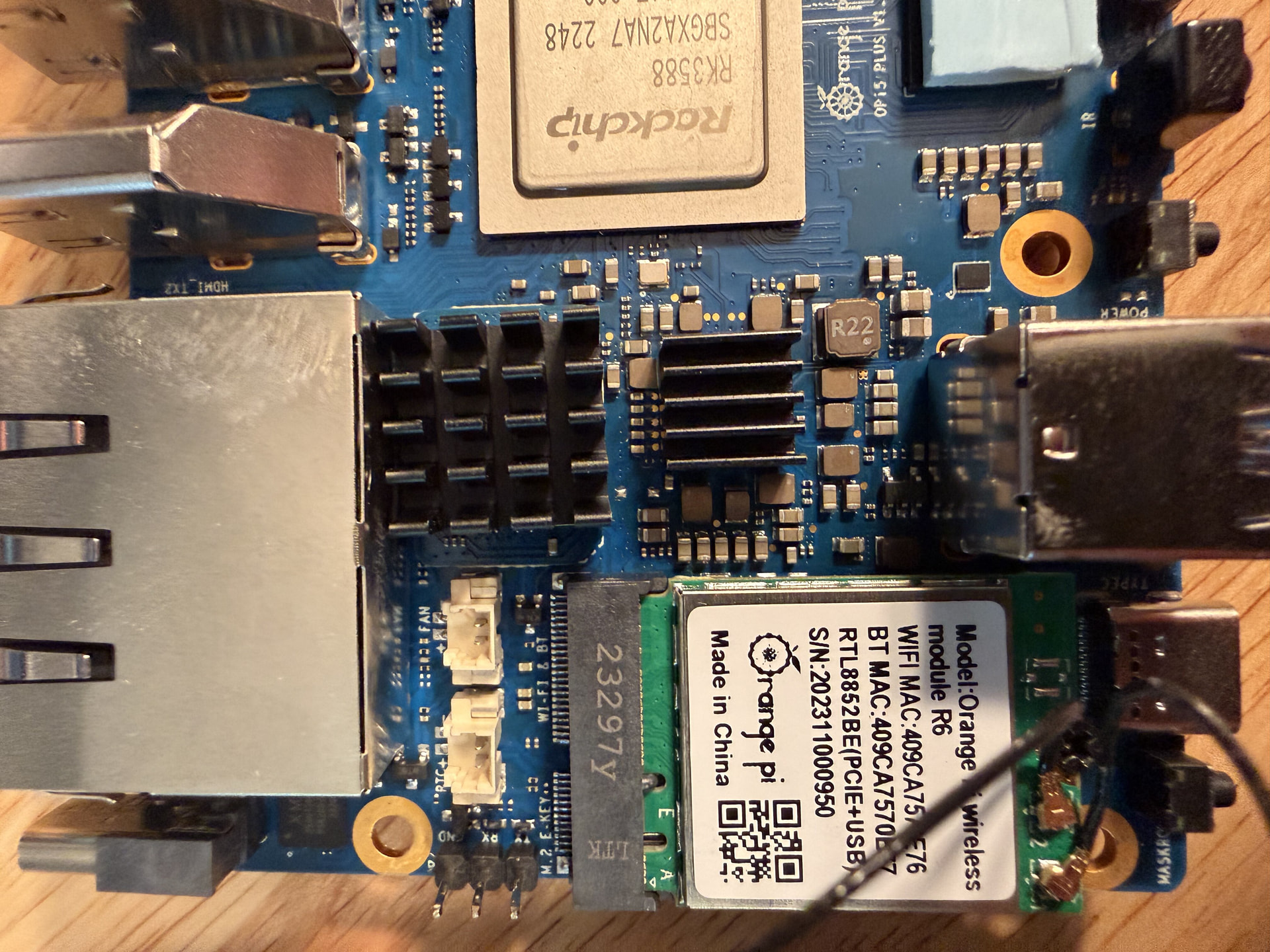

I did pull apart my OPI and check, the eMMC module on mine clears the fan connector without issue.
The first two photos should give you a good idea but TLDR is that it fits in there.
Also attached a few more photos I took just in case™ you wanted to compare something else on your board since I already had it apart.
I think I covered all the stuff we talked about. If there is anything else I can check, please let me know. Appreciate the work you do. :raising_hands:
I see, your eMMC module is a different one, with rounded edges. Mine has a sharp rectengular PCB. IIRC that SBC and eMMC module were an early revision, probably a sample, as I got it as dev sample. They probably reduced the eMMC PCB size a bit to make it fit better for release or in a later revision.
Ah! That explains it then. Mine does have corners that are beveled off.
I am not quite sure when this was produced, I bought it on eBay from one of those places that sells package content that were undeliverable. They had it listed as an 8GB model but I could see the tag on the bottom so I took a gamble. Came with everything — I have never used the wifi card but I didn’t want holes in the side of the case so I mounted the antennas and I didn’t want the antennas to not be hooked up. :sweat_smile:
Anyways, really appreciate all your help with this. :clinking_beer_mugs:

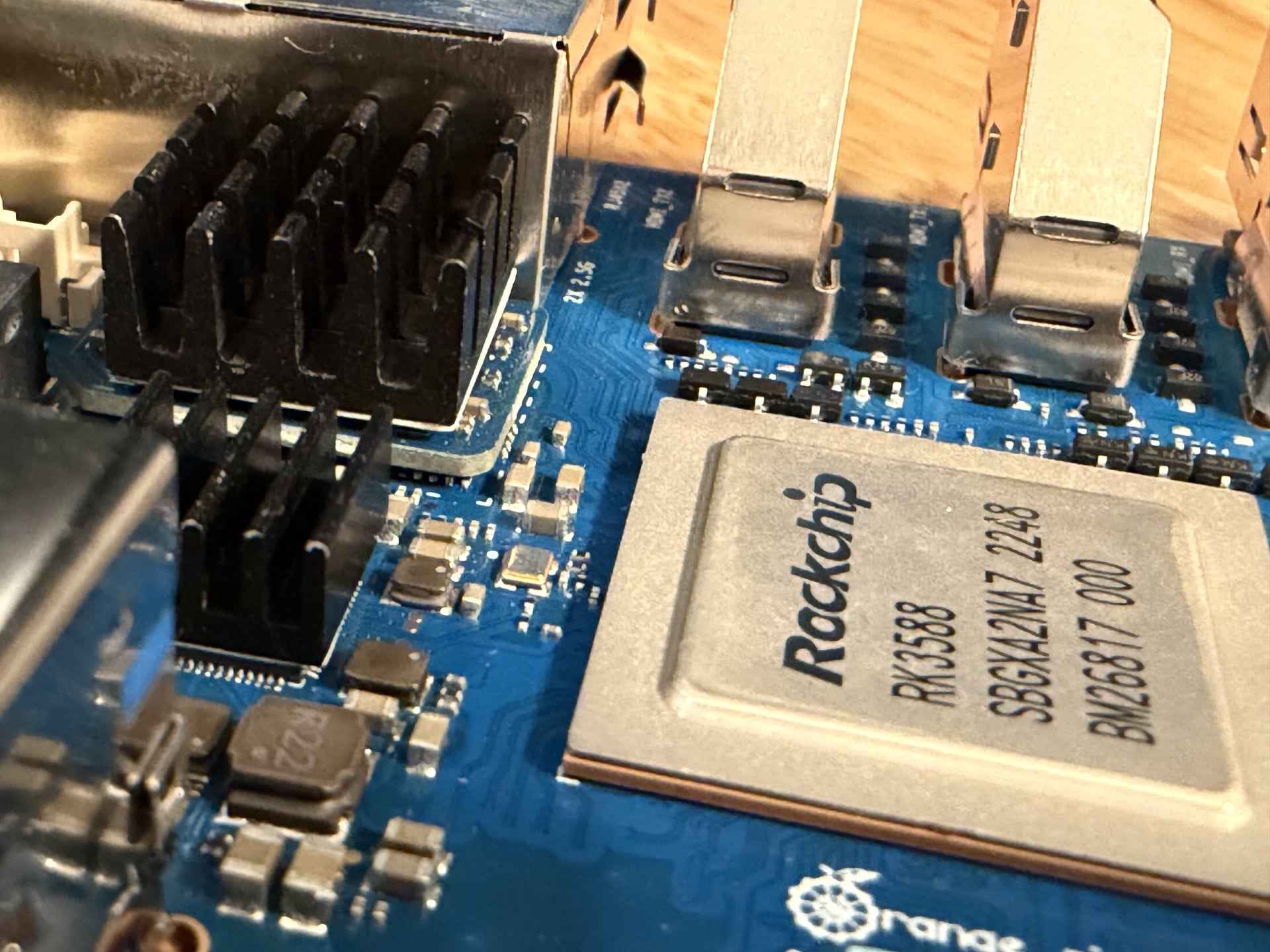

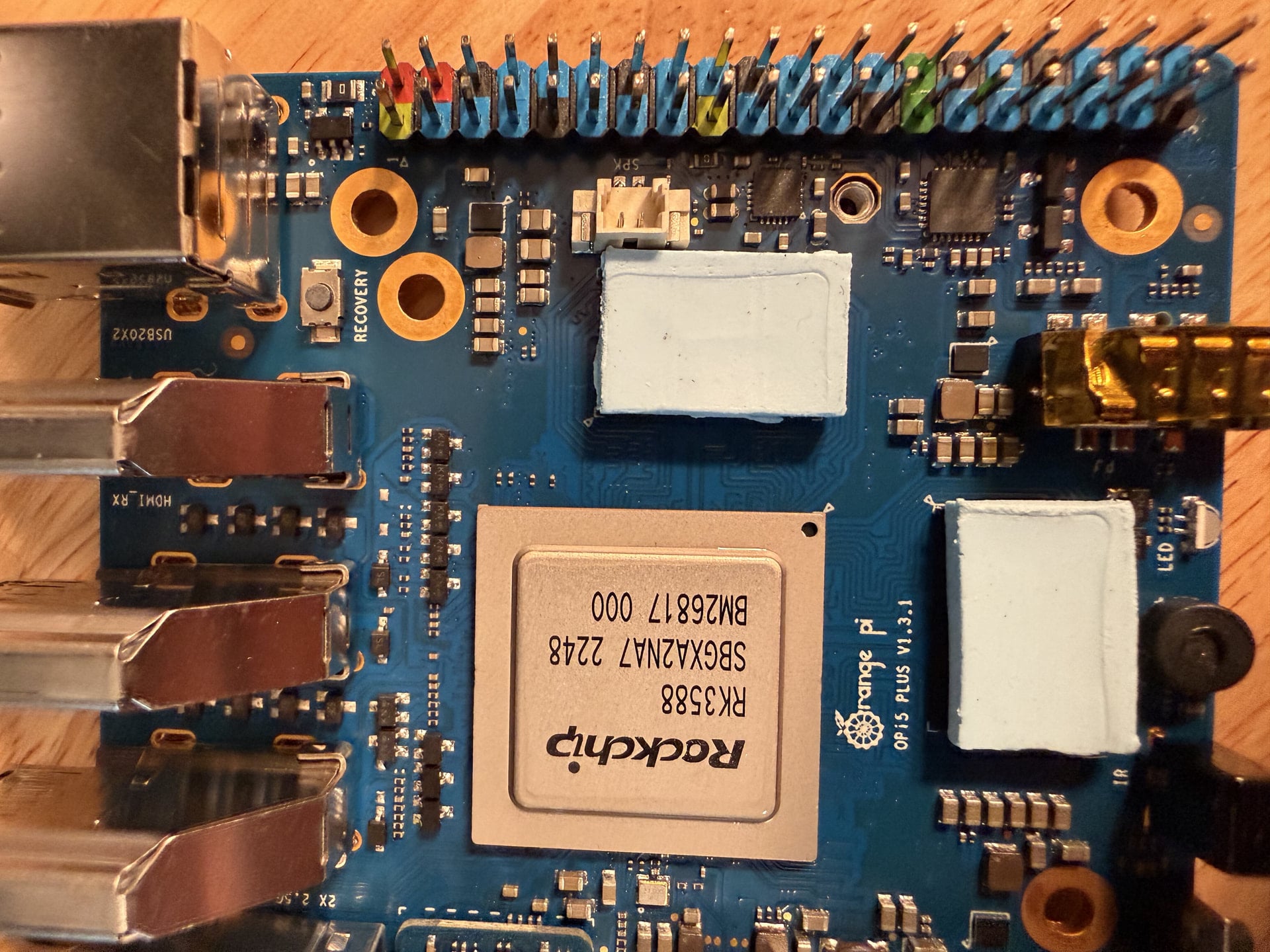

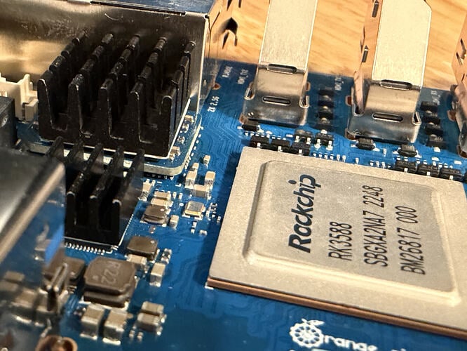

Are you running RK3588 without a heat sink? Please have mercy for it!
The official enclosure has a machined aluminum block that is attacked to the case and then the exterior of the case is used as a heatsink. I just stuck small heatsinks I had on the eMMC and the PMU to give them a little bit more thermal dissipation. Not super helpful without a fan but not useless either.
Under a stress test load it hits 62ºC after about 4.5 minutes and it appears to level off there in my 23ºC office. The warmest part of the chassis, right over the chip, hits 48ºC (118.4ºF) and the rest of the top hits 47ºC (116.6ºF). These run HOT and can pull a lot of power. Unfortunately, I think we are past the days where any modern/powerful SBC can run without a heatsink under any real load. :cry:

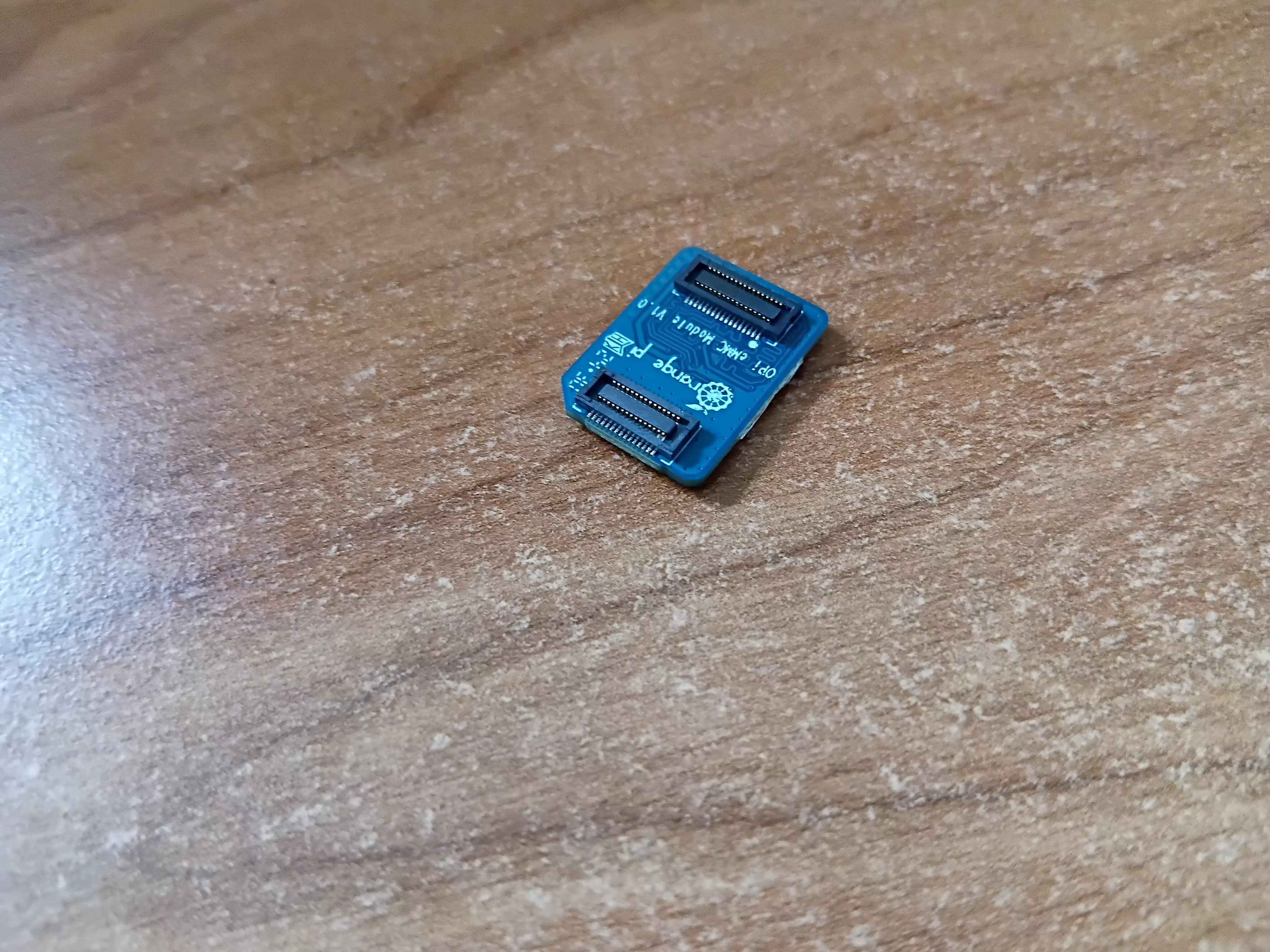

Ah, mine is the official Orange Pi eMMC module V1.0: Orange Pi - Orangepi
I mixed it up with the ones from FriendlyELEC in my earlier reply, which are the really sharp rectangular ones: eMMC Module for M6 / Zero2 / NEO3 Plus
Anyway, even that the ones from Xunlong have rounded edges as well, it is really tight on my board. With some more pressure, I can reduce the lift, but one can still see the larger shadow at the left side:
And it is not the module’s fault, as its connector is already at the max possible side:
So I guess the layout of the PCB changed slightly. Looking at the FAN connectors, they moved ~1 mm to the side in your case. See where the inner one is connected to the PCB, with the two lanes pretty much aligned with the “FAN” text on the PCB, while in your case, the “N” is not in front of the lane anymore.
Luckily, it does work regardless.
I do :sweat_smile:. But so far I never got it to any higher temperature, for the rather short testing sessions.
At least the RK3588 do not require active cooling like the Raspberry Pi 4 and 5, thanks to the quite efficient big.LITTLE/DynamIQ mix of stronger and weaker cores. Raspberry Pi clearly missed an IMO mandatory opportunity, rendering their SBCs to be among the most power-consuming (and heat-emitting) ones, while behind in regards of performance. And then no H.264 decoder on the RPi 5 adding to this.
