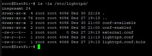

pls share your config file
cat /etc/lighttpd/lighttpd.conf

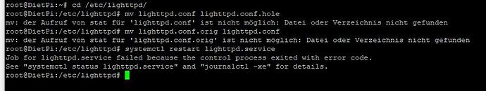

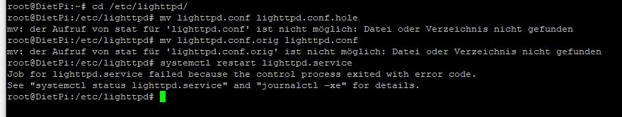

There is no need to do screen prints. You can simple copy you SSH output as txt

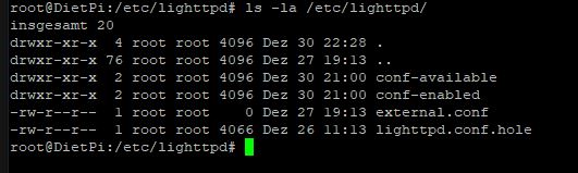

now everything is dead.
now config file isn’t found
did you removed? Ok let’s create a new one
nano /etc/lighttpd/lighttpd.conf
An empty file shoud open now. copy all of the following. Use the Select all button
