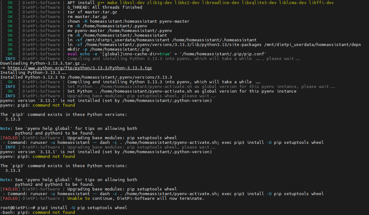

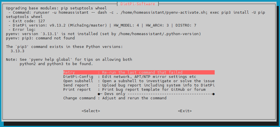

Home assistant reinstalling 157 won’t update from 2025.4.4 into latest 2025.5.3
below, screenshots of errors

Can you have a look into /home/homeassistant/.python-version. At least I don’t have that file on my demo system.
return “3.13.3”

Can you try to remove /home/homeassistant/.python-version and start reinstall of HA again?
Ok. works!
