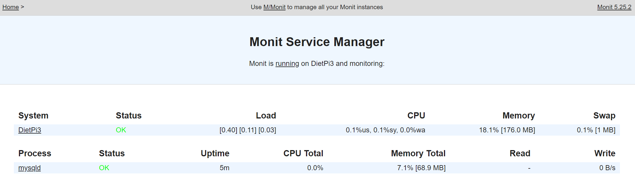

well this is not that simple as you would need to rewrite all the statement to use systemd instead of init.d.
For MariaDB is could look like this
 check process mysqld with pidfile /var/run/mysqld/mysqld.pid
   group database
   group mysql
   start program = "/usr/bin/systemctl start mariadb.service"
   stop  program = "/usr/bin/systemctl stop mariadb.service"
   if failed host localhost port 3306 protocol mysql with timeout 15 seconds for 3 times within 4 cycles then restart
   if failed unixsocket /var/run/mysqld/mysqld.sock protocol mysql for 3 times within 4 cycles then restart
   if 5 restarts with 5 cycles then timeout
not if this will work in reality but at least it’s shown up
