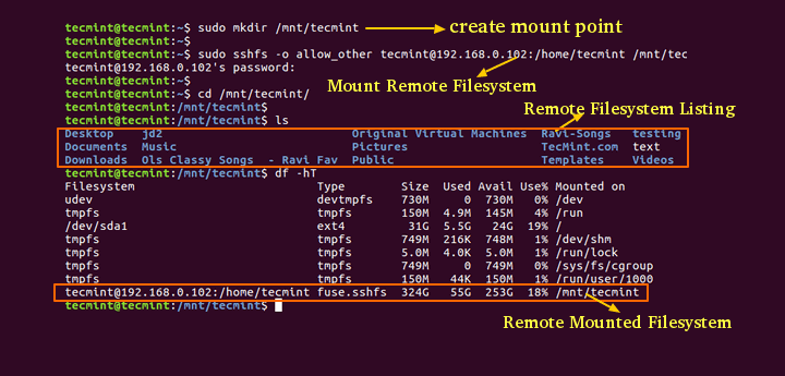

did some digging SSHFS
In computing, SSHFS (SSH Filesystem) is a filesystem client to mount and interact with directories and files located on a remote server or workstation over a normal ssh connection.[2] The client interacts with the remote file system via the SSH File Transfer Protocol (SFTP),[3] a network protocol providing file access, file transfer, and file management functionality over any reliable data stream that was designed as an extension of the Secure Shell protocol (SSH) version 2.0.
might try this
Or maybe have the local VPN into the network you want to mount and have it mount that way?
Well that is if DietPi and it’s kernel builds support SSHFS
This way…it can connect and mount securely thru SSH…which is a VERY good thing because it’s a secure tunnel
This listing shows a pretty nice way to set it up
