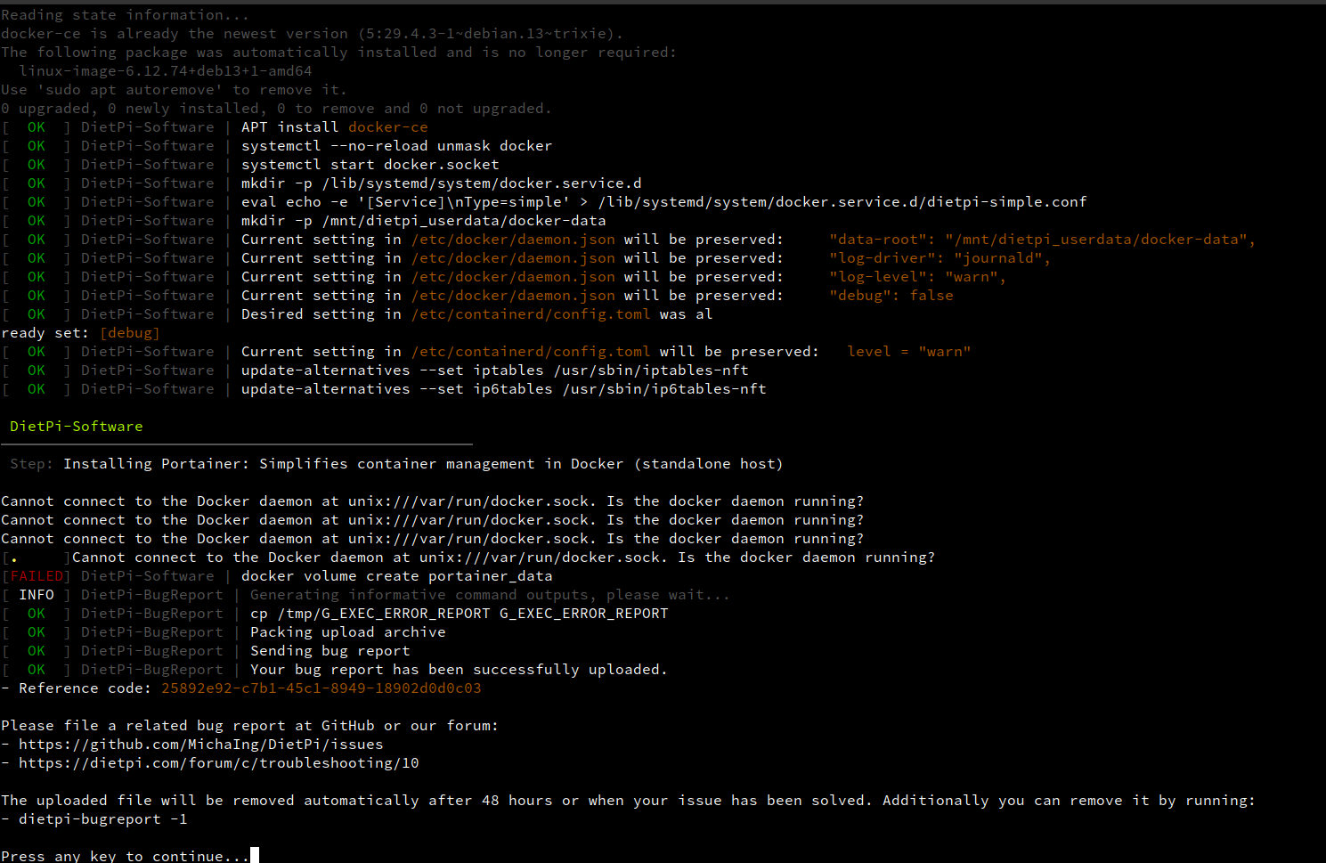

Trying to update Portainer 2.39.1 to Portainer 2.39.2
- sudo dietpi-software reinstall 185
Should update Portainer to version 2.39.2
The update process stops with errors:
Cannot connect to the Docker daemon at unix:///var/run/docker.sock. Is the docker daemon running?
[FAILED] DietPi-Software | docker voluma create portainer_data
After cancelling the reinstall process due to the error, Portainer and Docker stay off and don’t restart. Had to reboot to restart all services.
this is strange because the volume should not be created if already exist.
Means this should not happen on reinstall
Problem seems to be Docker engine as it is not available while you try to reinstall.

It seems Docker is masked, which prevents it from running.
May 08 21:46:19 DietPi systemd[1]: docker.socket: Failed to queue service startup job: Unit docker.service is masked.
May 08 21:46:19 DietPi systemd[1]: docker.socket: Failed with result 'resources'.
Please run dietpi-update and apply live patch 2.
Didn’t cross my mind to check that. It worked.
