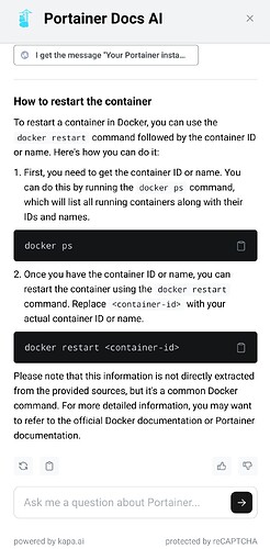

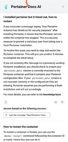

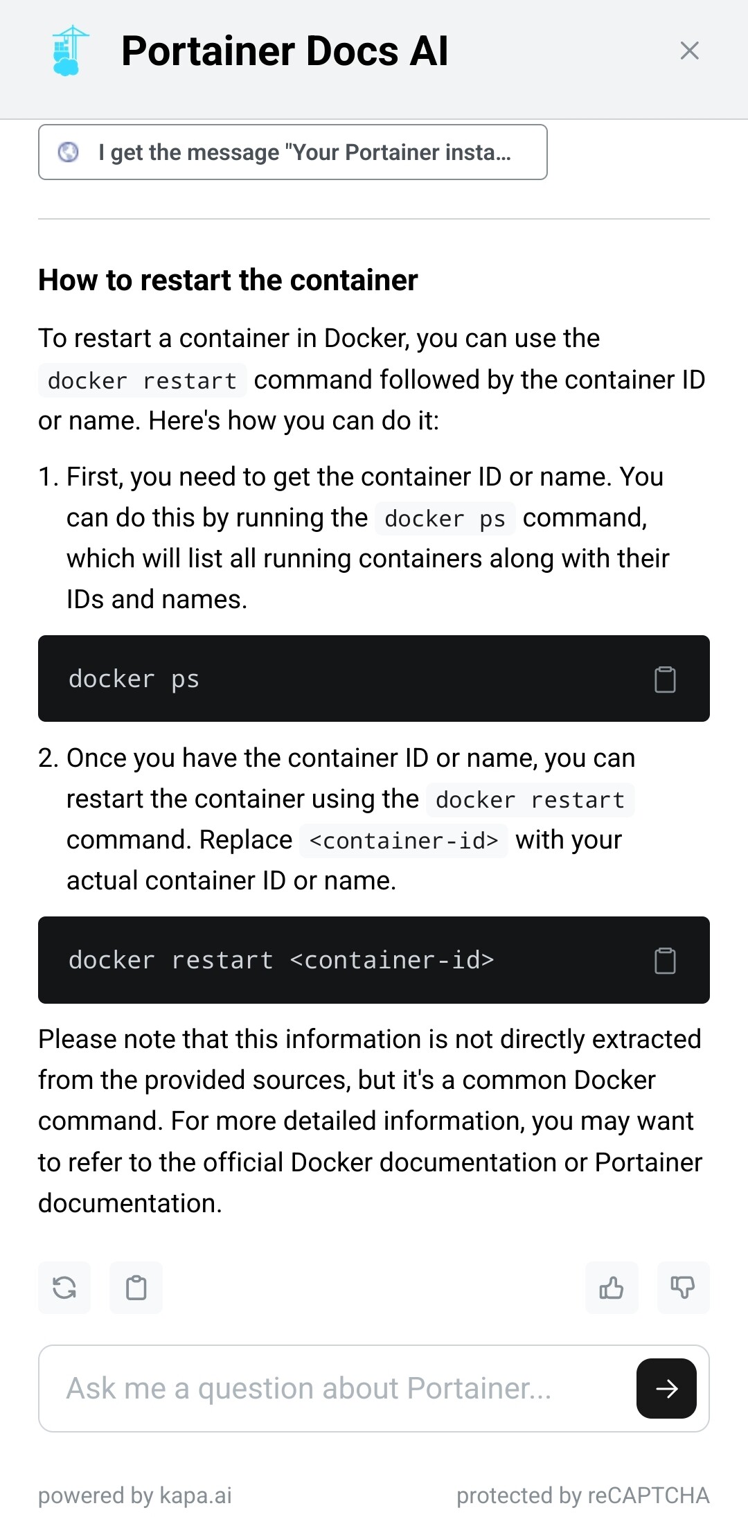

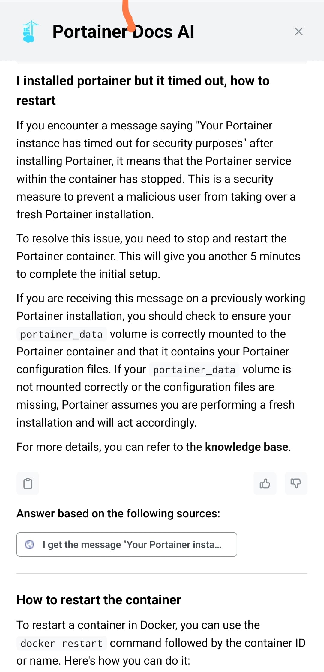

Portainer docs even have a freaking AI chat bot, so I got this in under 5 minutes:
