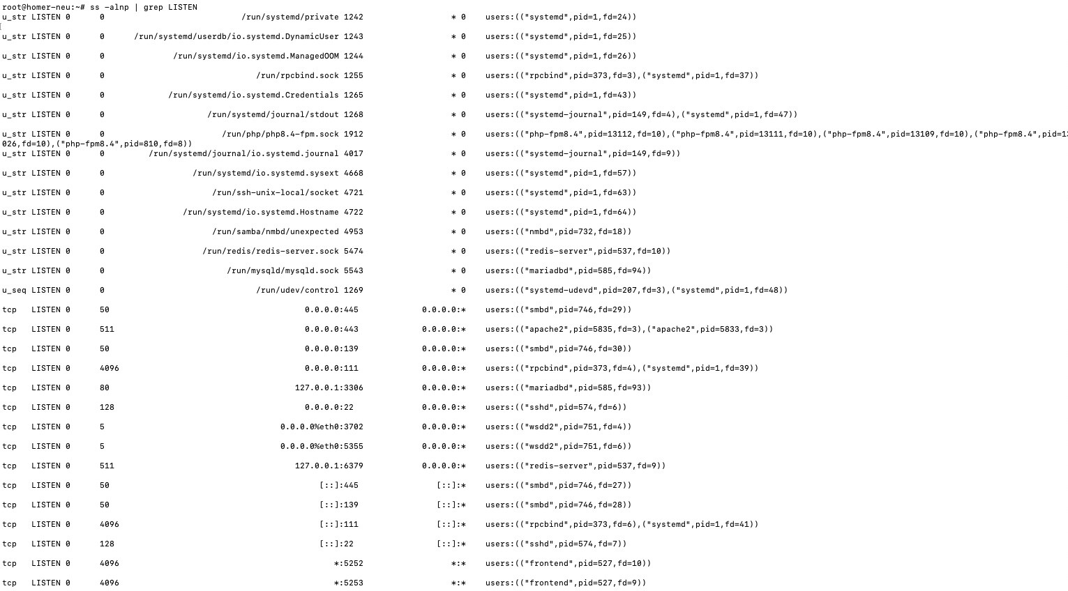

can you check LISTEN ports
ss -alnp | grep LISTEN

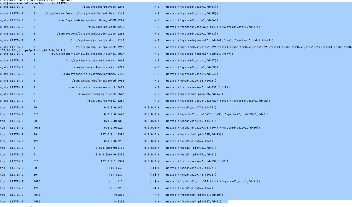

Hi, Version 1 & 2 ( blue with 8443 )
Hope it helps
Tks
ok and what is the issue now? Apache has been successfully moved from port 443 to 8443
