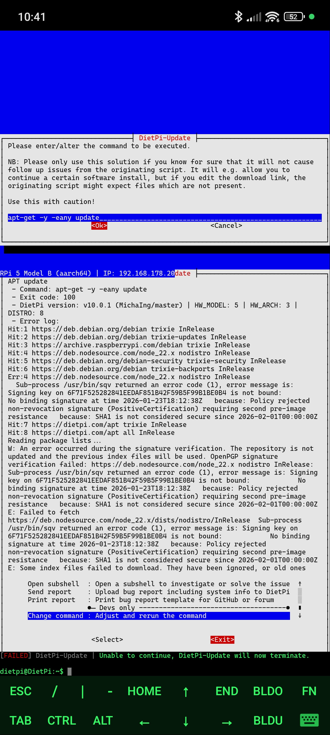

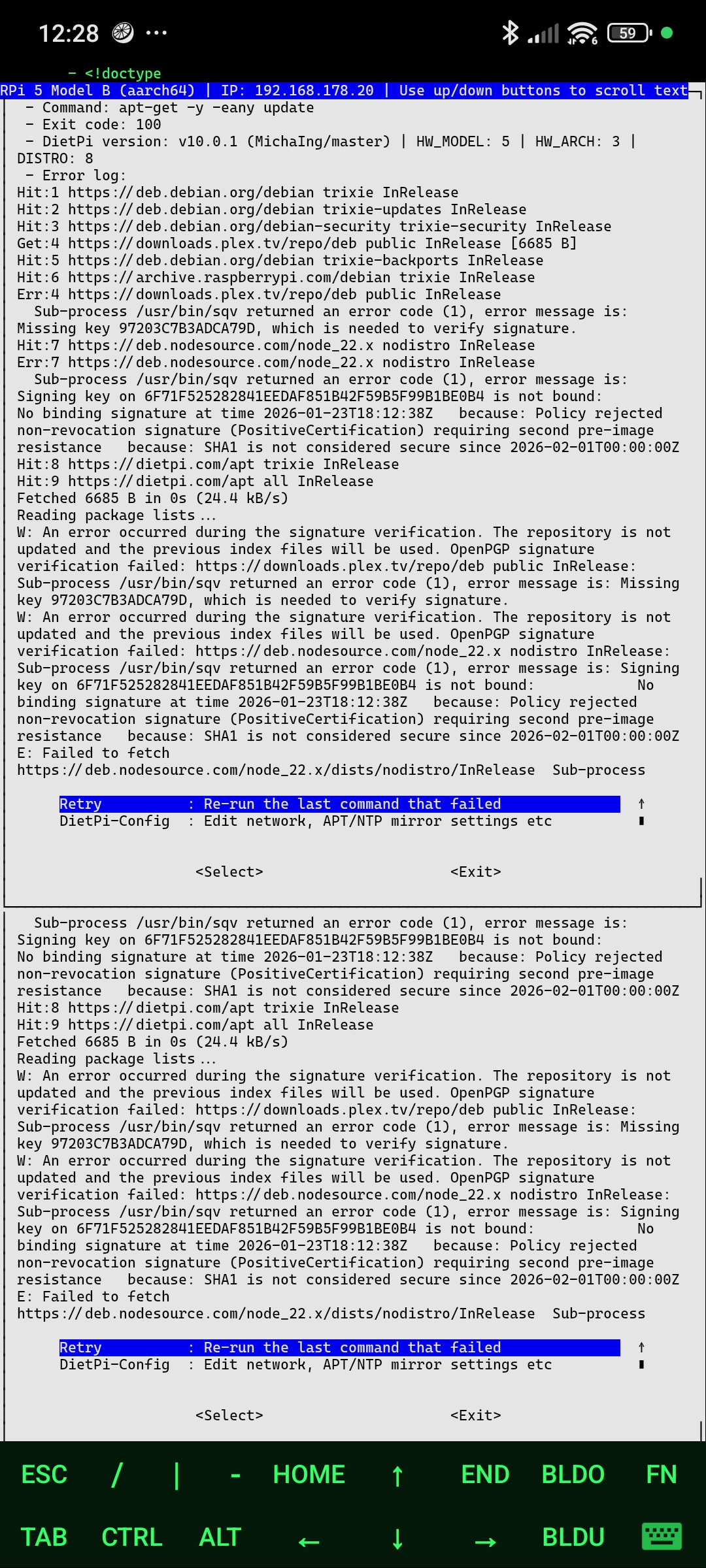

Since updating to Trixie, I’ve been getting yellow error messages in the console for Plex and Node. I was told here in the forum that this isn’t a problem and it continued to work.

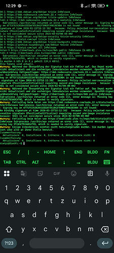

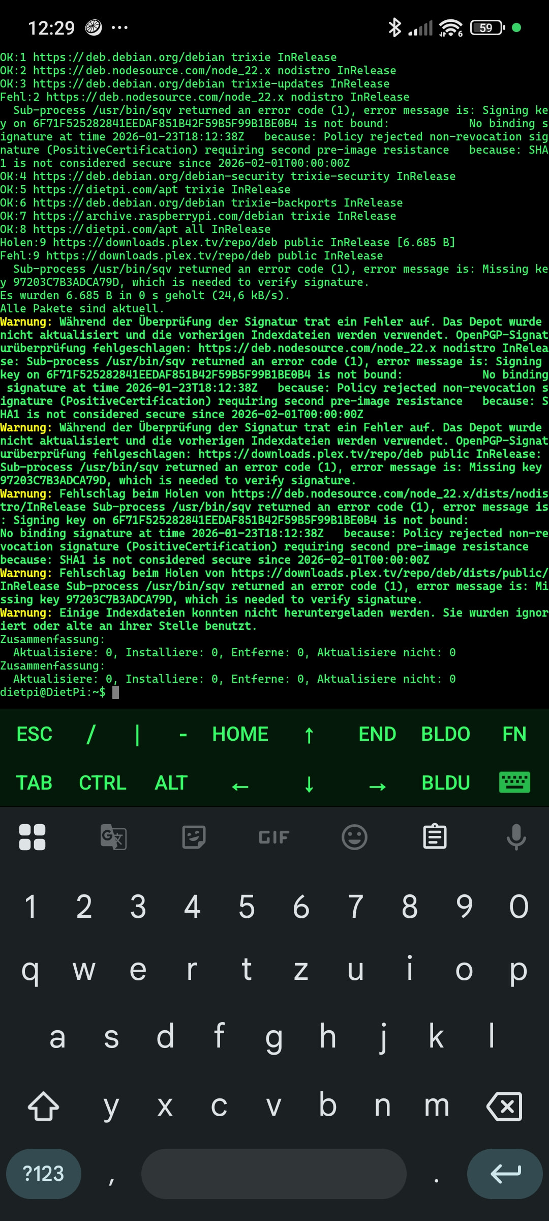

But since yesterday it no longer works; Plex has an update and it simply won’t install.
Unfortunately, I’m not familiar with this and just follow copy and paste instructions, but I did take screenshots.
Raspberry Pi 5.
