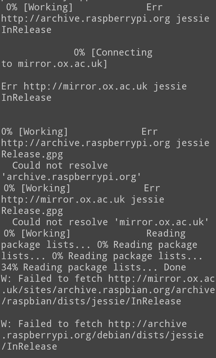

Can you ping www.google.com or any other url?
Might be you need to ensure (if using static IP) that /etc/network/interfaces has a default gateway and dns set to your home router
So i succeed to get out from my Raspberry.
Can connect to internet, to run apt and all
