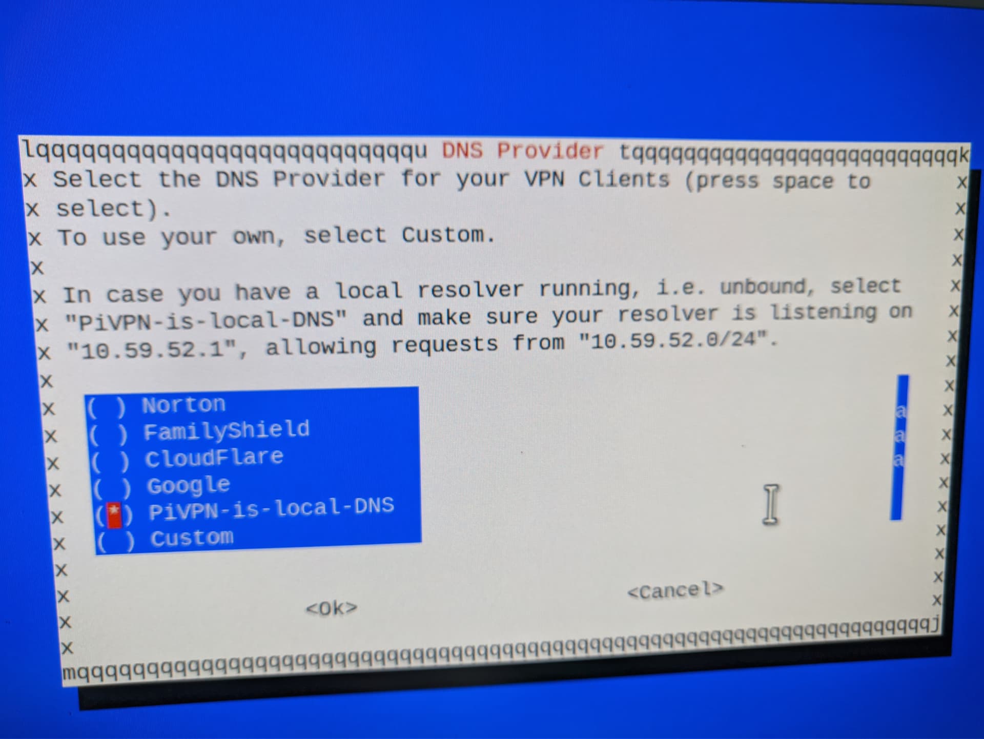

I already had unbound installed through dietpi-software with default config, working fine. I then installed PiVPN (again through dietpi-software), and got to the section about choosing DNS Provider, the correct option appears to be…
'In case you have a local resolver running, ie unbound, select ''PiVPN-local-DNS and make sure your resolver is listing on ''10.59.52.1'', allowing requests from ''10.59.52.0/24''. '
I don’t know how do the resolver listing and requests part. I just went ahead anyway and the tunnel connects but only ipv6, no ipv4 .

Simply choose PiVPN local DNS. Unbound is working same away as Pihole.
Thank you, that’s what did, tunnel comes up, but no ipv4 (only ipv6).
Might be an unrelated issue then?
