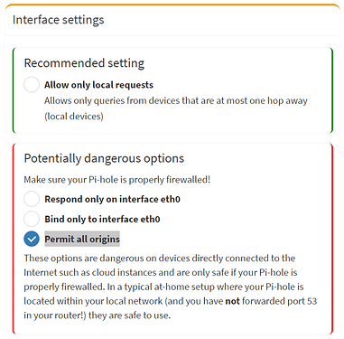

Regarding PiHole (even if not related to this issue), it is important to set the interface to Permit all origins
This way PiHole was working on a reboot for VPN clients as well.
How can I do that on DietPi?
you already did :wink: Usually you should see the services starting.
