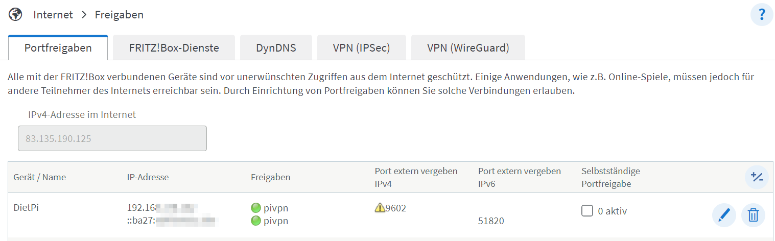

So I once set up pivpn (Wireguard) on my raspberry pi 2 via dietpi (Debian).
I followed a guide (which I can’t find anymore). In that guide I should open the port 9063 on my router (FRITZ!Box).
All worked like a charm for 3+ years. Never had to touch anything.
Now last week I changed my ISP and pivpn (Wireguard) stopped working.
So I looked in my port forwarding of my router and saw that my new ISP does not support the chosen pivpn port 9063 anymore
It now has to be a port from the range: 9708-9727
Is there a hassle free way to change now my pivpn setup without generating new Wireguard codes or reinstall everything?
If yes what do I need to change?

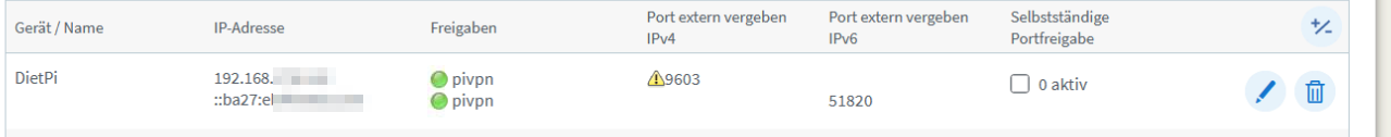

Im also getting more and more confused. I don’t know where the internal port 9063 comes from? I didn’t choose it. I checked the Wireguard config file and the Wireguard debug log and it also shows there the standard 58120 external port.
And if you see above first screenshot the error comes with internal v4 port 9063. not the external ip6 51820 port (which is also in port forward)?
So 51820 is in Wireguard config file and in the port forward

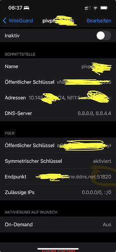

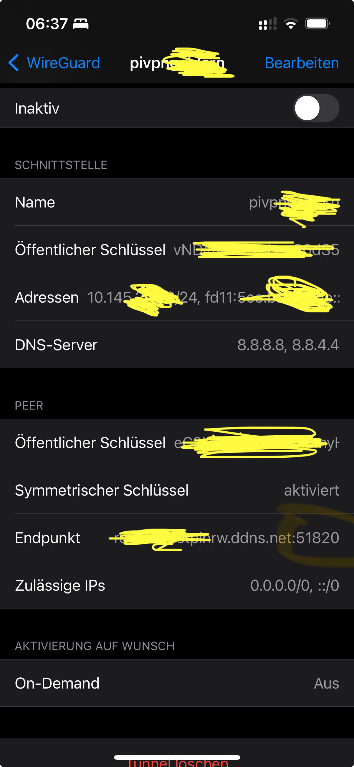

Have a look at your client (not on the server,). Open the Wireguard app on your mobile device and check the port configured there.
If I am now not mistaken, the Wireguard config file for my client (iPhone) gave me a port 51820
In this case set the same as external IPv4 port on your Fritzbox

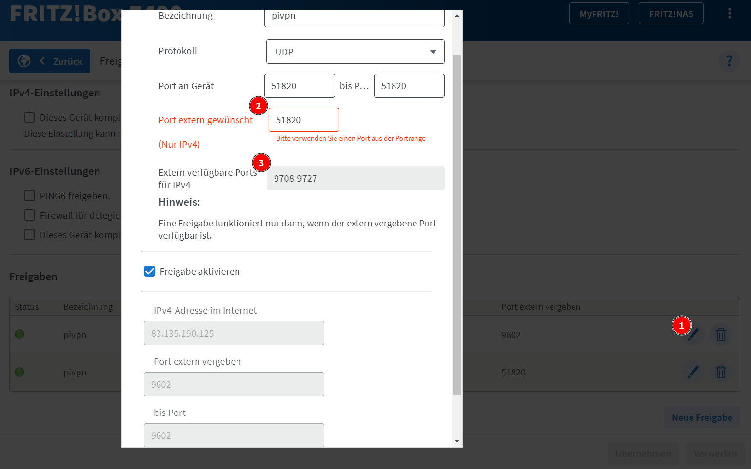

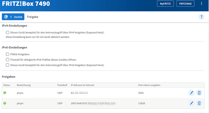

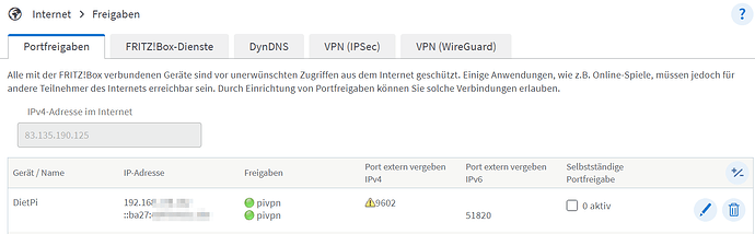

My Port Forwarding in my fritzbox. (worked until last week, when i changed my ISP)
if i try to edit this entry:
I use DDNS from no-ip to always be connected to my wireguard server, even when my ip address change

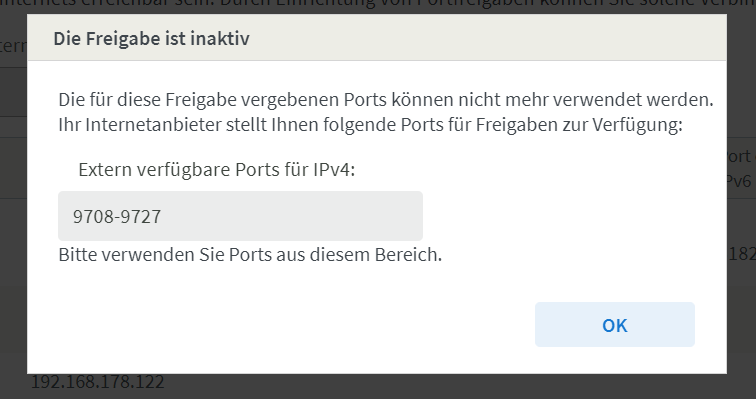

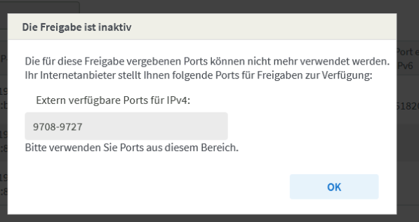

When i click on “1” to edit it says that external port is 51820 (At “2”). But its read and says in german that i should use a port in the allowed port range of my new ISP (9708-9727).
So i assume i would need to change in the port forwarding the port from 51820 to something else?
but also my pivpn (see debug log) is configured to 51280, so i also need to change there something to match the new port from the range.
and then change all wireguard client configs to the new ports as well
Wtf your ISP is reducing ports.
Anyway select one of these external ports and change to the same on your client. No need to change internal ports or server configuration
i have no idea, why my ISP is reducing ports. all went rock solid before. after ISP change it wasnt working anymore.
changed port forward in my fritzbox router (the red marked part) to 9708 and in all wireguard clients the endpoint address to 9708 as well
→ It worked!
