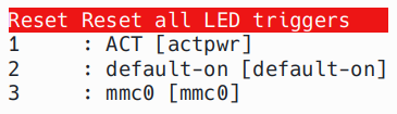

You can check led settings using dietpi-led_control
Thanks, so it’s a feature, not a bug! I didn’t knew about the led_control settings yet, great to know!
It is probably the ACT [actpwr] trigger that makes the 0,5 second flashing I was seeing. Glad it wasn’t a power issue.
Simply play with the settings and adjust them in your needs
