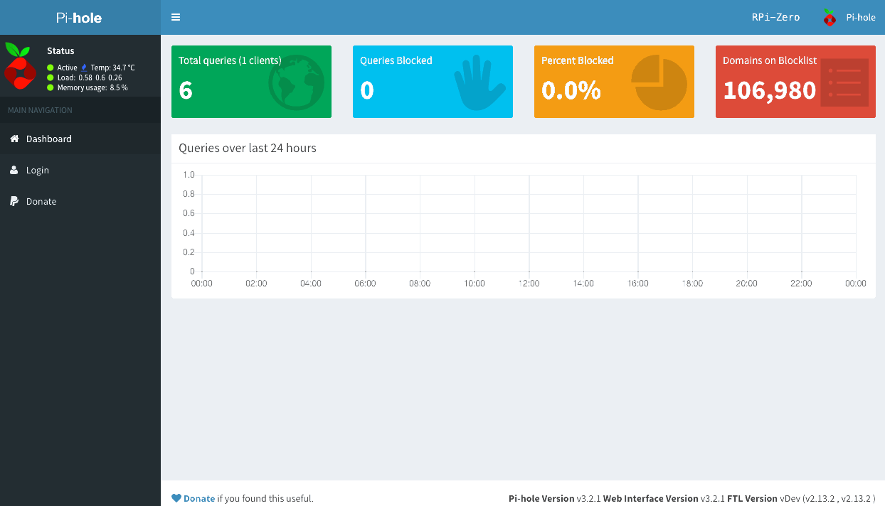

Extra check pihole installation on RPi Zero (HW_MODELL:1) here right now on a fresh image: DietPi_v6.0_RPi-ARMv6-Stretch.img
Works like a charm, without errors.
 DietPi     | 10:15 | Mon 29/01/18
 v6.0       | RPi Zero W (armv6l)
 IP eth0    | 192.168.10.100
root@RPi-Zero:~# dietpi-services status
[  OK  ] Root access verified.
 DietPi-Services
 Mode: status
[  OK  ] cron   active (running) since Mon 2018-01-29 10:15:39 CET; 10min ago
[  OK  ] lighttpd       active (running) since Mon 2018-01-29 10:15:40 CET; 10min ago
[  OK  ] php7.0-fpm     active (running) since Mon 2018-01-29 10:15:51 CET; 10min ago
[  OK  ] dnsmasq        active (running) since Mon 2018-01-29 10:15:53 CET; 10min ago
[  OK  ] pihole-FTL     active (running) since Mon 2018-01-29 10:15:54 CET; 10min ago
