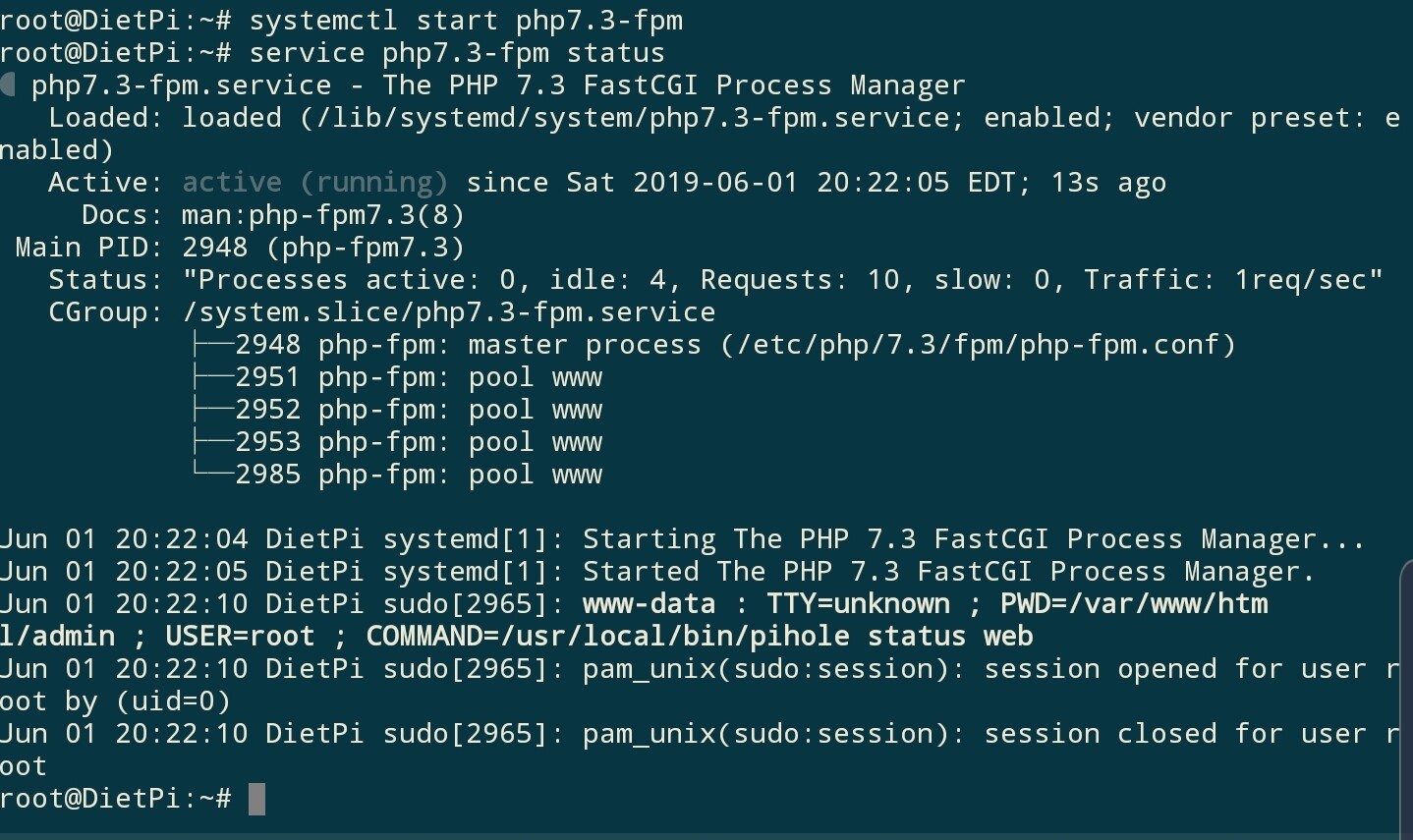

I have now gotten to a point where if I enter the command
systemctl start php7.3-fpm
the web interface will work correctly until I reboot.
If I reboot and run
service php7.3-fpm status
it shows
Active: failed (Result: timeout)

journalctl -u php7.3-fpm :
root@DietPi:~# journalctl -u php7.3-fpm
-- Logs begin at Fri 2020-11-27 10:46:22 GMT, end at Fri 2020-11-27 21:05:51 GMT. --
Nov 27 10:47:09 DietPi systemd[1]: Starting The PHP 7.3 FastCGI Process Manager...
Nov 27 10:47:10 DietPi systemd[1]: Started The PHP 7.3 FastCGI Process Manager.
Nov 27 11:29:04 DietPi systemd[1]: Stopping The PHP 7.3 FastCGI Process Manager...
Nov 27 11:29:04 DietPi systemd[1]: php7.3-fpm.service: Succeeded.
Nov 27 11:29:04 DietPi systemd[1]: Stopped The PHP 7.3 FastCGI Process Manager.
Nov 27 11:29:23 DietPi systemd[1]: Starting The PHP 7.3 FastCGI Process Manager...
Nov 27 11:29:23 DietPi systemd[1]: Started The PHP 7.3 FastCGI Process Manager.
Nov 27 11:30:29 DietPi systemd[1]: Stopping The PHP 7.3 FastCGI Process Manager...
Nov 27 11:30:29 DietPi systemd[1]: php7.3-fpm.service: Succeeded.
Nov 27 11:30:29 DietPi systemd[1]: Stopped The PHP 7.3 FastCGI Process Manager.
There it is, I’ve noticed that when i Try to acess my Nextcloud via the web interface it shows me the same message
