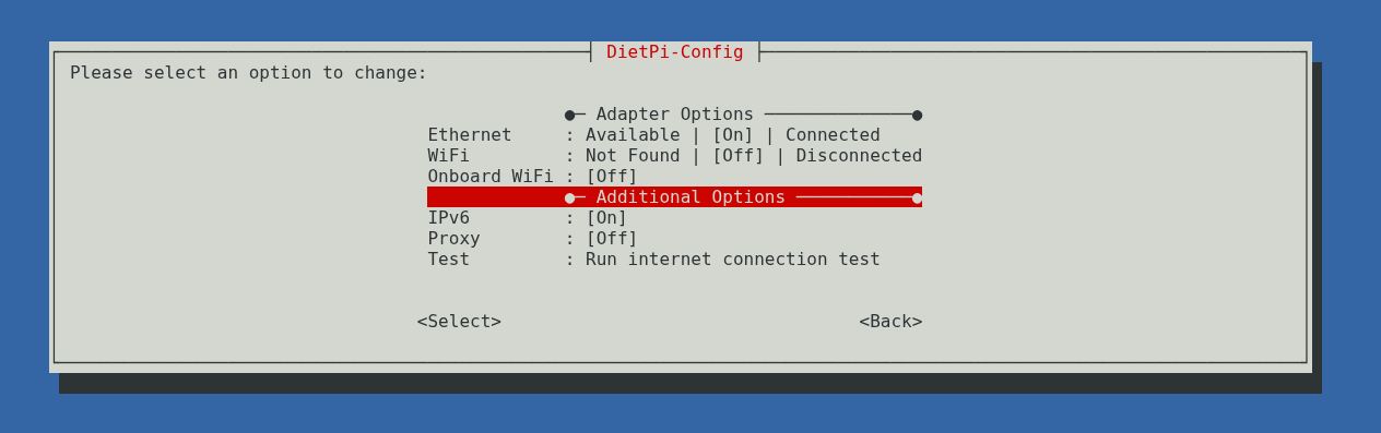

Have you enabled IPv6 in dietpi-config > Network Options: Adapters first?
Yes I have. It’s been enabled since the day I installed dietpi.
