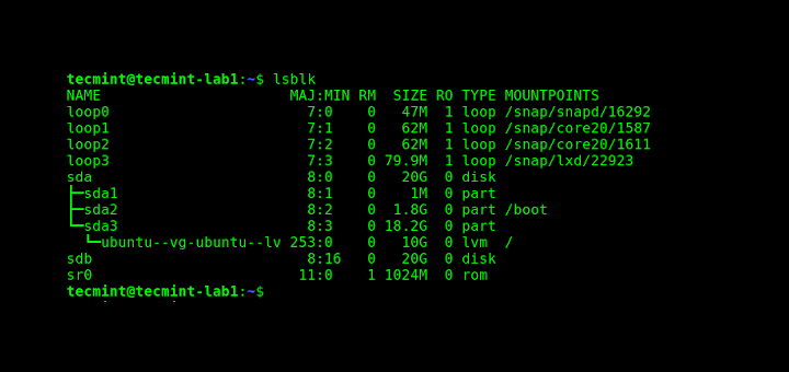

List the UUID with several methods
sudo ls -lha /dev/disk/by-uuid
or
sudo df --output=source MYFILE | tail -n1 | xargs lsblk -o uuid
or
sudo lsblk -o +uuid,name (which shows mount point)
or
sudo lsblk --output NAME,FSTYPE,LABEL,UUID,MODE
https://www.simplified.guide/linux/disk-uuid-get
