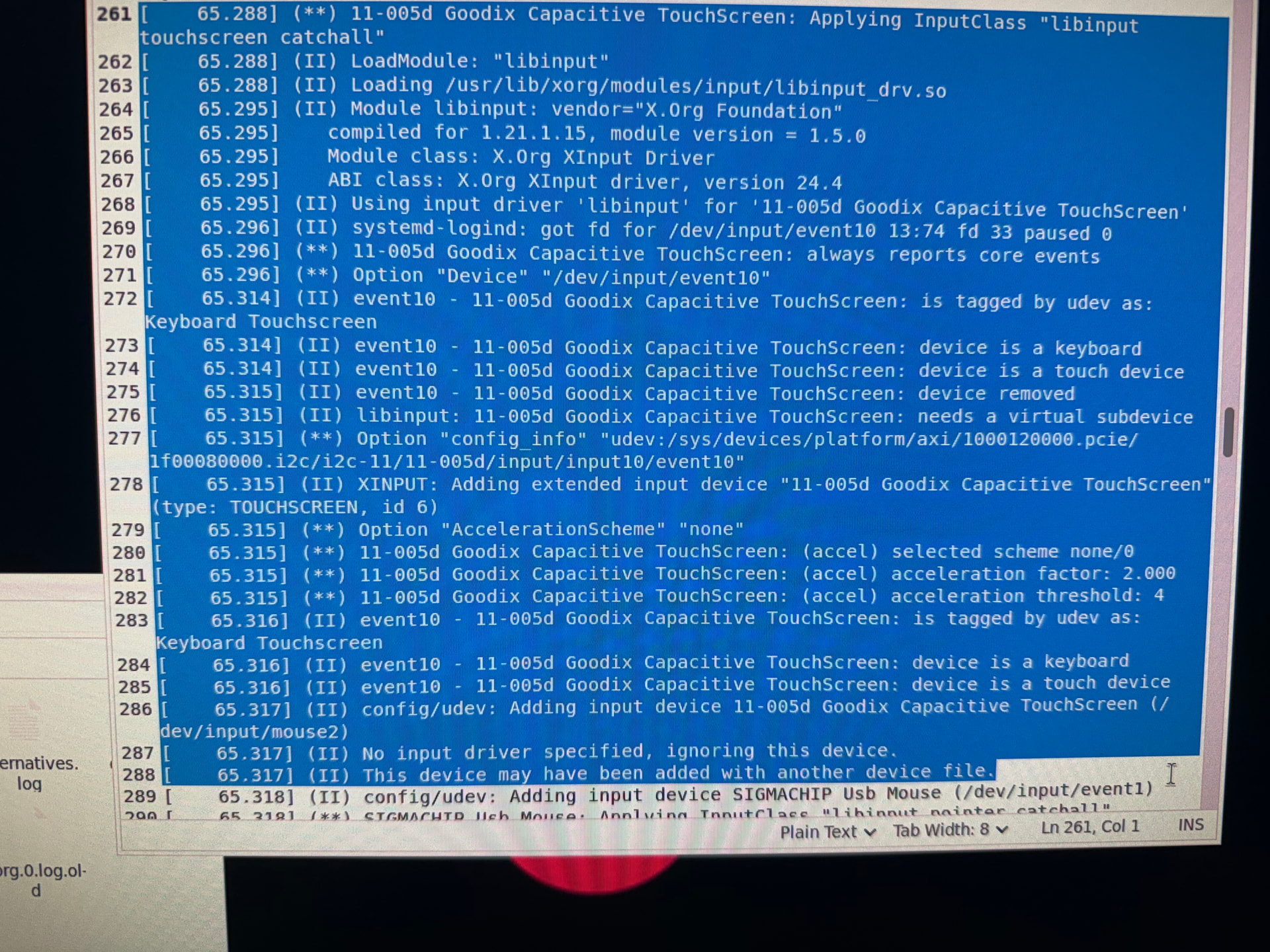

I tried this, it doesn’t work unfortunately. Looks as if maybe my X11 isnt loading on the screen properly based off some of the error messages I get?

There should be a log file at /var/log/Xorg.0.log
I’m thinking this might be part of my issues? I’m not quite sure what to do with this info? If any of yall have any idea of what I could do to solve these issues I would appreciate it.
Seems like this is only about the touch capability, but not about the display functionality.
Can you post the log as text?
