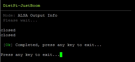

I have configured the sound like this:
The option “ALSA Output Info : View info on current ALSA playback stream” delivers:

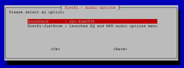

When i go to to “dietpi-config” and further to the audio-settings i see “rpi-bcm2835”, which is RasPi-hardware (i think).
Is DietPi limitted to RasPi audio only? But the Extension-Board doesn´t seem to have an extra soundchip on it.
