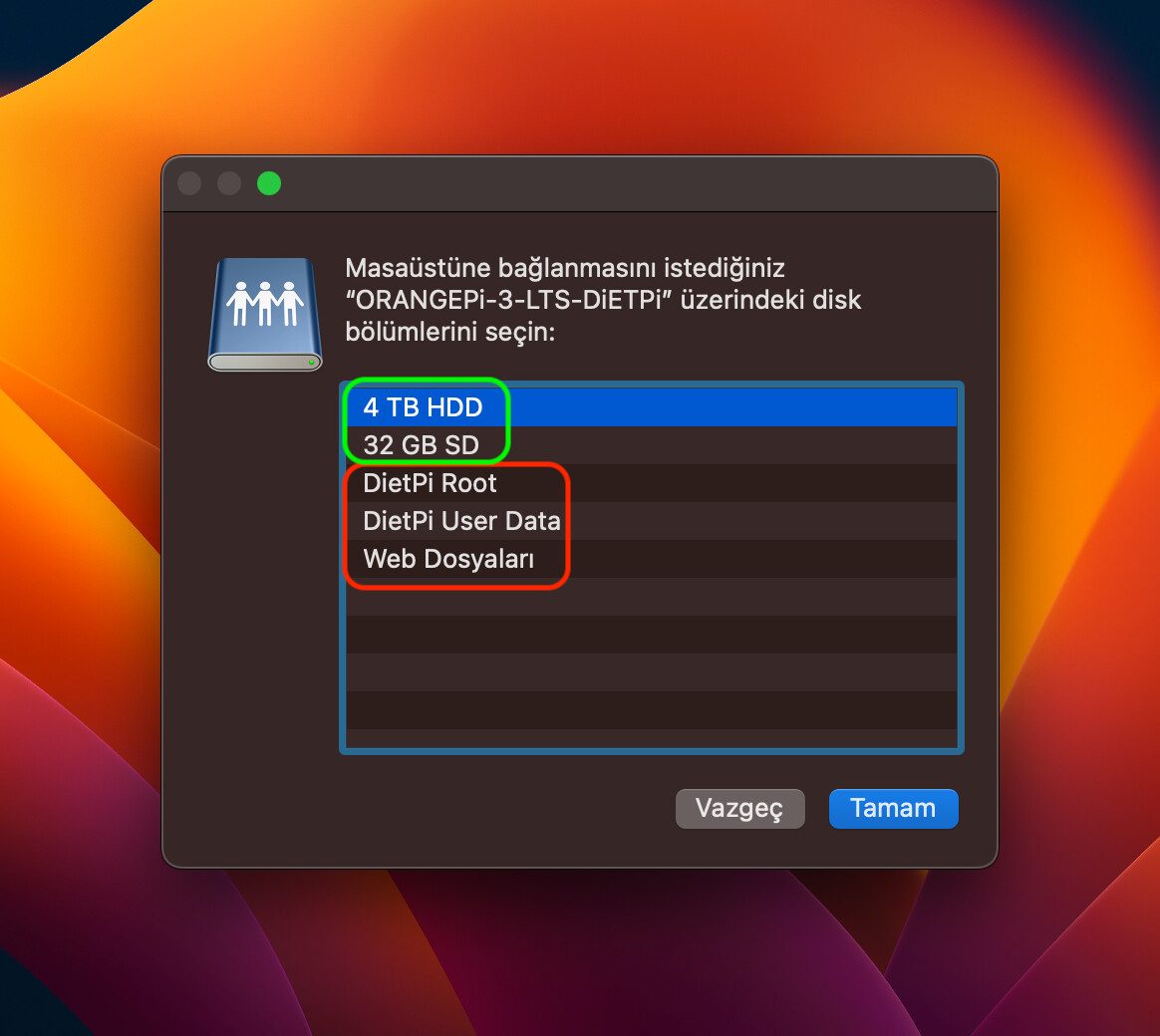

ı’m using 2 MacOS device both of them are not connected red one’s

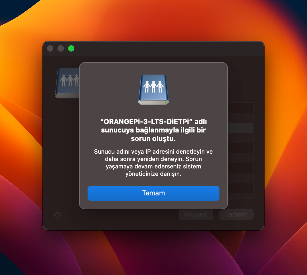

when i click on the red ones it gives a pop up like this
In comment please look the second message
I am connected via smb://IP with root user
Windows and android phone is connected via native file manager with red one’s
---- Additional info: when i connect to my router via ethernet I can get 80-90 mb/s (usb 3.0 hdd speed limit) speed over samba file transfer, but when I connect with wifi (1300mbps or sometimes 866mbps on at near router) I see maximum transfer rates of 10-13 mb
Why is this caused?
Translated version of text: There was a problem connecting to the server named “ORANGEPi-3-LTS-DiETPi”.
Check the server name or IP address and try again later. If you continue to have problems, consult your system administrator.

My big problem is, i can’t access / (root filesystem) by using smb on macos
are you able to access at least one of the SAMBA shares? Or is it impacting all shares?
4 TB HDD and 32 GB SD (green box) is accessible, red box are not accessible from MacOS (also accessible from windows and android native file manager via smb)
