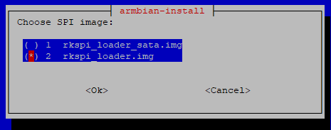

… one more thing, when you say
dietpi-config → Advanced Options → Update SPI bootloader → rkspi_loader.img
You really toggled rkspi_loader.img with backspace, so it has this asterisk?
Because if not, if you just hit return when it is highlighted, it would pick the first one, which annoyingly is the SATA image. Not sure about the impact in that case, whether it would not detect the SSD at all, or whether it can result in your case of boot into initramfs + fsck but failing mount.
I just extended a commit in our fork to also switch this to a menu, which makes the selection easier and less error-prone: rockchip64: prevent SPI flash from exiting parent shell · MichaIng/build@98c77b4 · GitHub

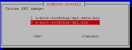

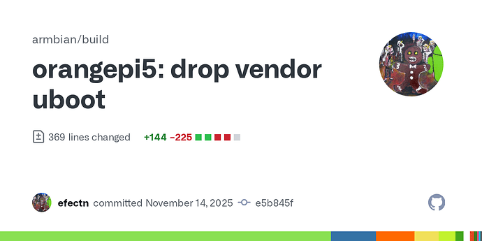

EDIT: Oh while testing the new menu, I recognized that Armbian switched to mainline U-Boot for this board, just a week ago:
Testing that one, with our menu vs radiolist:
One key less to type. The benefit of the new U-Boot binary vs prior image is that it does not flash the whole 16 MiB via dd, but only the ~1.6 MiB binary,via flashcp, with is much faster. Let’s see whether it solves the reboot issue and/or boots faster …
Haha yeah both:
  • Boots after 11 seconds into kernel vs 61 seconds before
  • Does not hang at reboot
Merging this build now … done.
@Renoria now I am kinda certain this will solve your issue as well, but Armbian most likely did not update the U-Boot package within the last week? You can try it like that in case:
